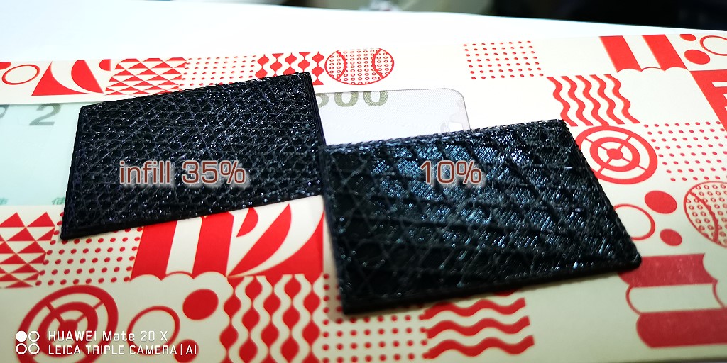

Finally done with TPU, took me 72 hours …
Thanks for all your suggestion, it helps a lot :slight_smile:
Here’s my TPU print setting :
The result (black part) :
