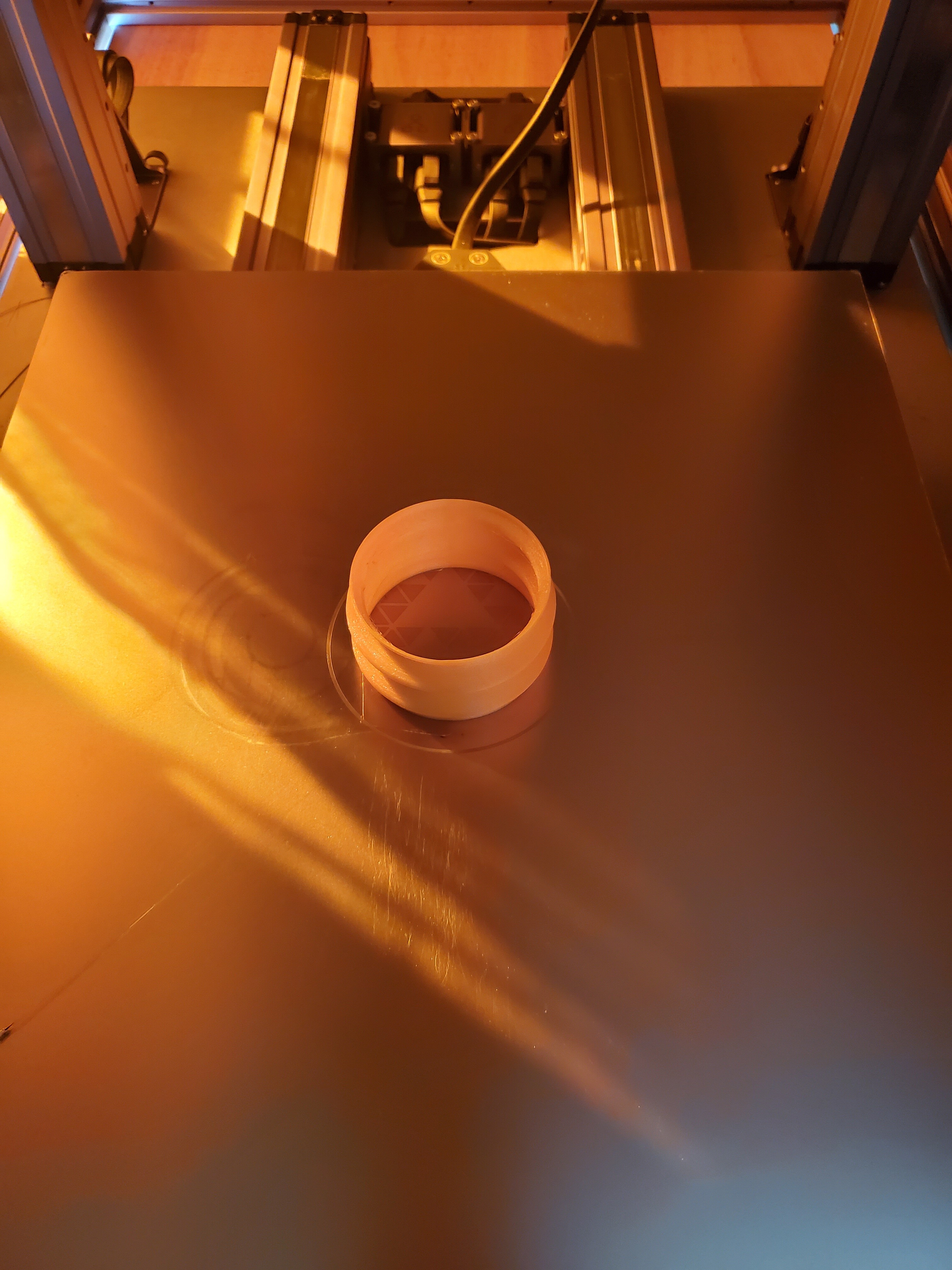

I print with TPU on a regular basis without an adapter with the Snapmaker A350 and I found that for the key is to print in the 228 C range and go slow (test for max speed you need based on quality and what won’t kink the filament). Here is a skirt I designed with a wall thickness of 3.6 mm and again with 0.8 mm.
