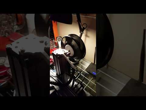

Filament Spool / Reel Adapter
All adapters are designed to fit on the metal spool holder that ships with the snapmaker. Inside diameter of about 8.5mm.
Instructions:
Print:
2 x Bushings
2 x Washers
1 x Adapter to match your Spool
Assemble: bushing, washer, adapter, washer, bushing (depicted in picture & video).
Currently available adapters:
Makerbot .2kg Spool Adapter - 53mm diameter by 30mm wide.
For this spool you will want to use:
2 x 15mm bushings
2 x "Washer"
Snapmaker Spool Adapter - 57mm diameter by 50mm wide.
2 x 5.25mm bushings
2 x "Washer"
Hatchbox 1kg Spool Adapter - 54.5mm diameter by 68mm wide.
For this spool you will use:
2 x 5.25mm bushings
1 x "Washer"
1 x "Hatchbox1kgWasher"
Since the Hatchbox spool is wider than the snapmaker spool holder I had to cut out some of the inside of the adapter. This leaves it so you can’t put a washer on the outside of the spool holder like normal. To get around this just super glue the hatchbox1kgwasher onto the outside of the adapter. I will post a picture of this in case the above doesn’t make any sense.
These are the only spools I have, if you want an adapter made for another spool send me the measurements!

Updated post. Added adapter for Hatchbox 1kg spool.
Added Shaxon 1kg Spool Adapter
