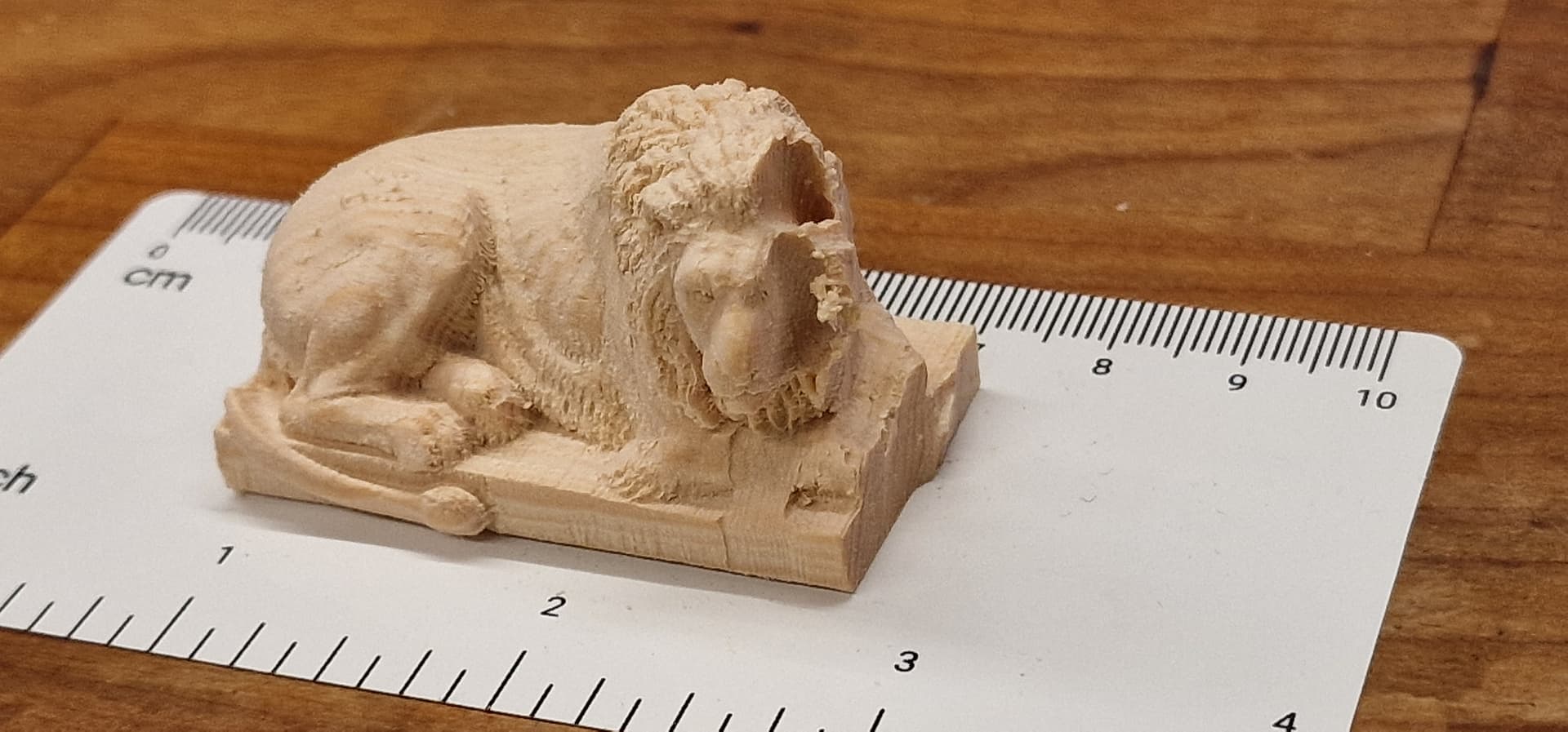

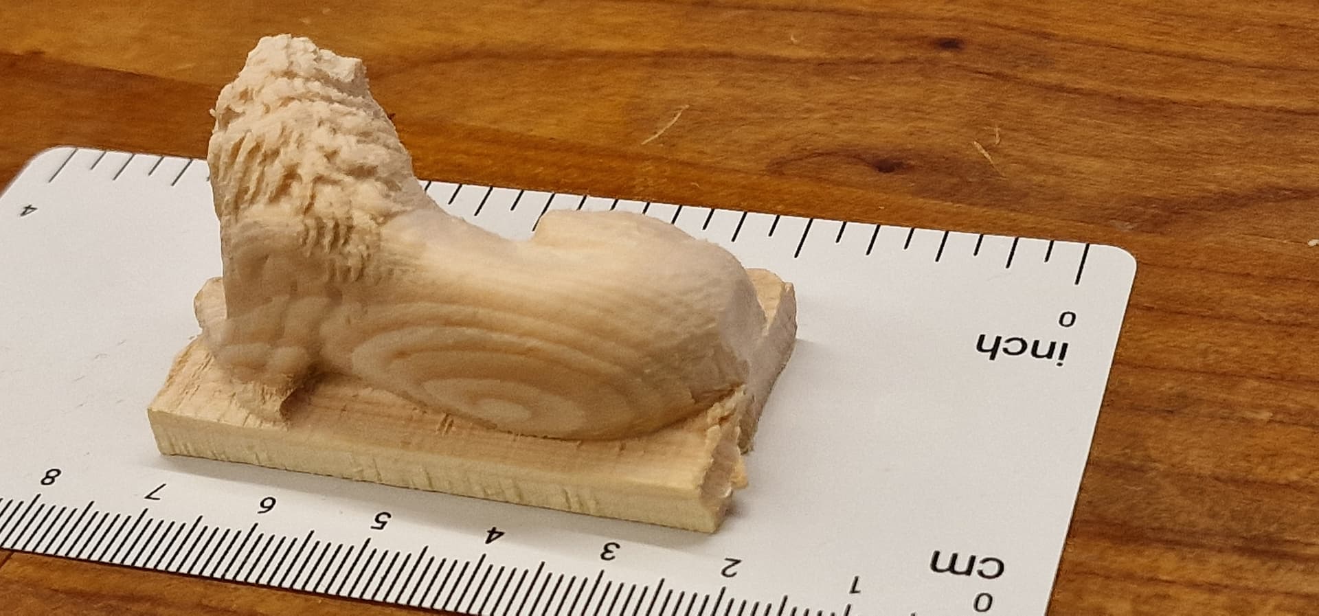

Over two years and still the 4-axis mode is not functional.
Agreed: The math behind this is truly complex. Rotation and the x and y Axis resulting in hyperbolic curves, that is hefty and definitely nonlinear math.
The dimensions of the drillbit including shank length and diameter as form and length (or better rotary silhouette) of the working part need to be taken into account not to push in too deep to non cutting section of the bit or worse to the collet or drilling through overhanging parts from already milled slices.
Luban does not handle neither of those challenges well.
As a consequence it just cut the snout and arse (including the tail) off an in all other aspects finely carved lion!
