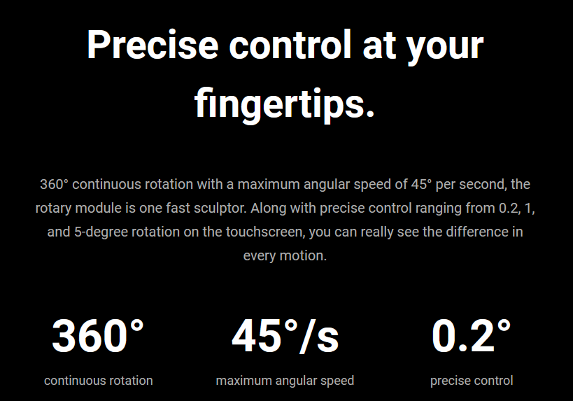

Just for the information on this thread, I’ve done some in depth testing of this and found the max speed the rotary can do is 2700deg/min. Neither Luban or the Snapmaker controller actually do the math to convert deg/min to mm/min surface speed calculation with the diameter.

Should not be too complicated… Circumference of a round object is 2πr, where r is the radius. The circumference is 360°. So rotary speed ω [°/s] to linear speed v [mm/s] would be (r in mm):
v = ω 2πr / 360° = ωπr/180°
So 45°/s for an object with 50 mm radius translates to 45°/s x π x 50mm / 180° = 39.3 mm/s
mm/s to mm/min is trivial, just *60s → 39.3 mm/s x 60 s/min = 2356 mm/min.
Or you enter ω in °/min directly, same.
