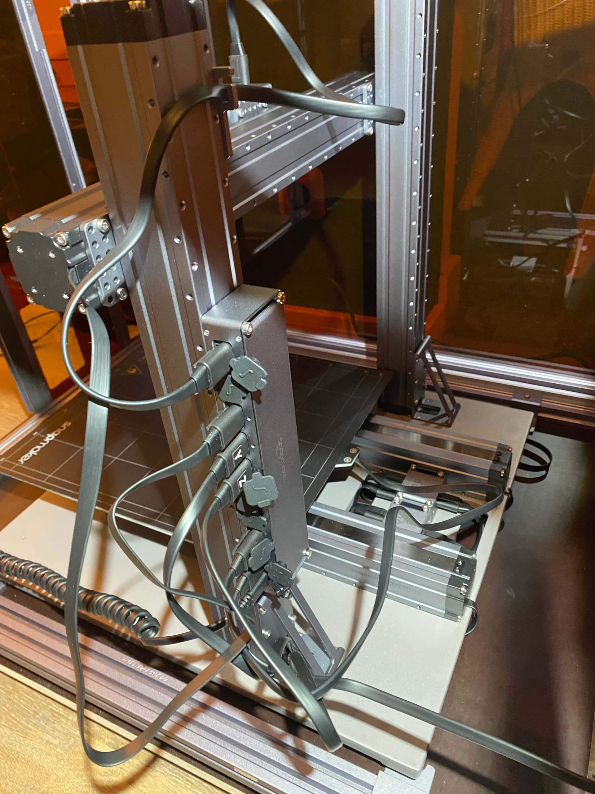

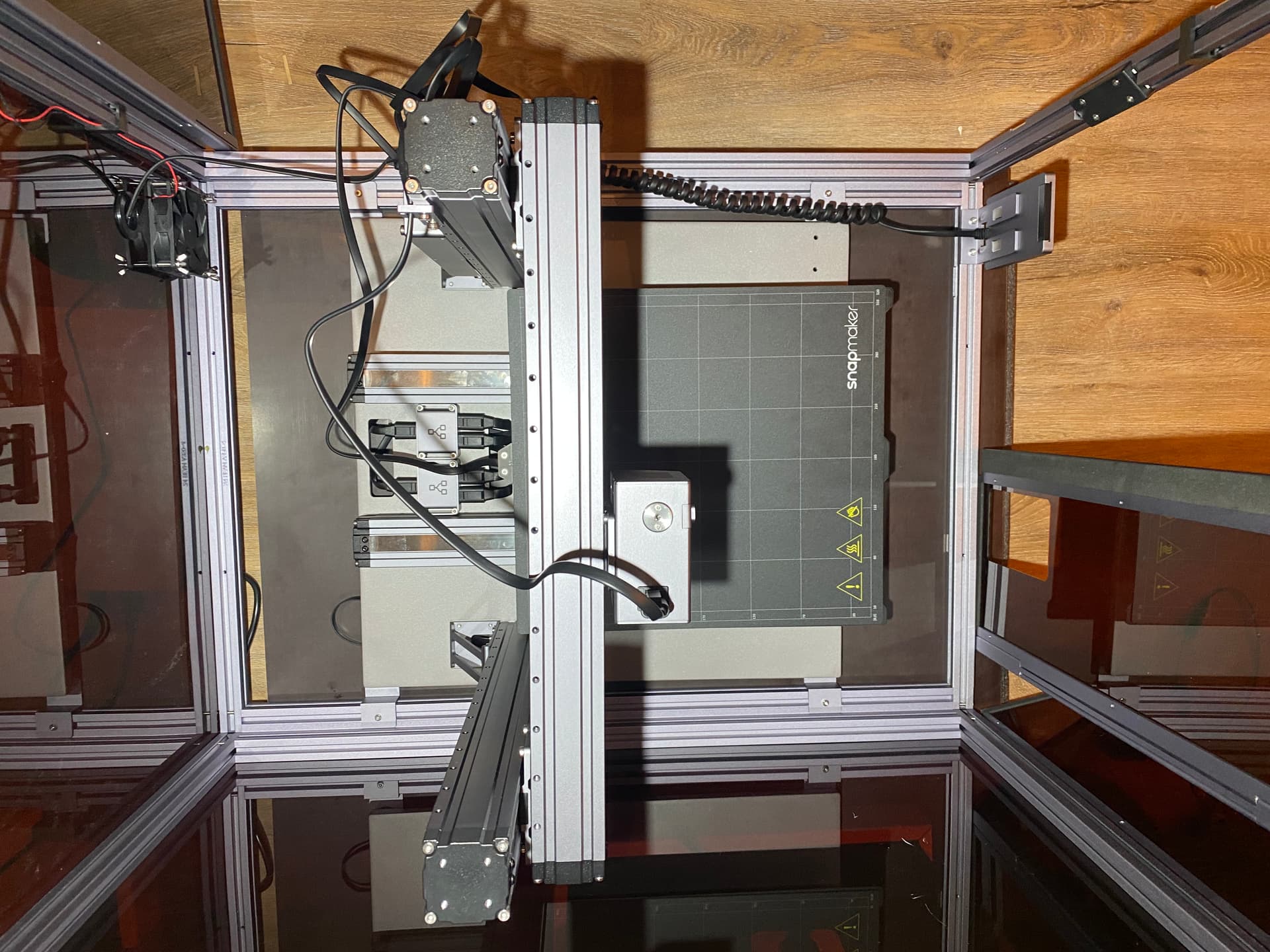

Hi, I am new to the Snapmaker family and got my machine yesterday.
Unfortunatly I ran into a problem right away:
When starting the machine for the first time the initial calibration fails. The toolhead moves to the left side and the screen immediately tells me to level the last part manually. When I try to tap „up“ or „down“ or „save“ however nothing happens.
I checked the cabeling five times and everything seems to be okay. I also plugged the y cable into z slot to test what would happen. Same result.
I am not too familiar with the forum yet but I checked for similar problems. But everyone seems to have a different experience with failing calibration.
Maybe someone has an idea?
Can you share video (might have to use an offsite host since you’re new) or describe better what’s happening?
Also if you could show some pictures of your SM from various angles so we can check the assembly.

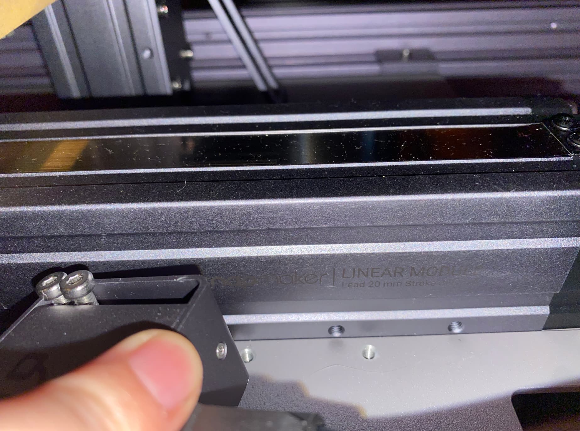

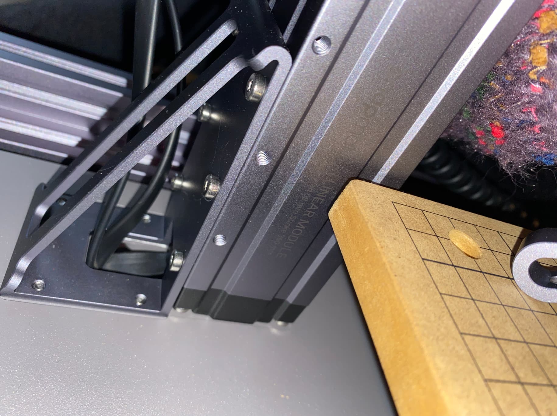

It looks like you have the A350T model. This has the new linear modules. These are different for the different axis. I can see markings on the side of one of the modules in one of your pictures. But can’t read them. (the older ones don’t have markings)
Are you 100% sure you have used the right linear module pair for each axis?
My first idea would be that you mixed those up.
Hi thanks for the tip! I’m pretty sure they’re all in the right place though.
And yes, I have the A350T model.
It’s a little hard to see but I took fotos:
20 mm for the bottom two, 08 for the vertical ones, and the remaining 20 mm as the x.

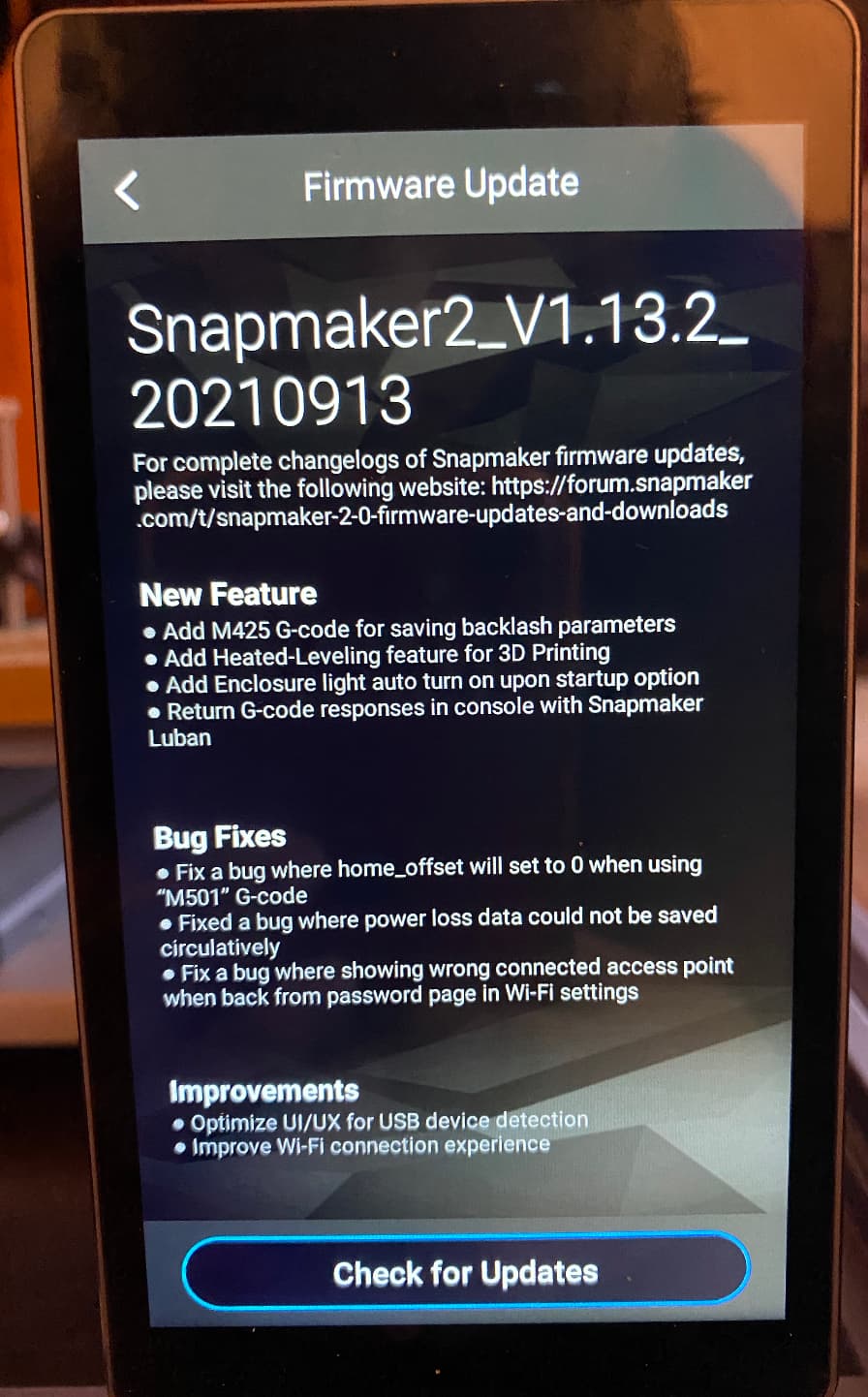

I figured out how to update the firmware now. Did that. No change with the CNC. Got the “check your settings” error again.
Also I found the “control” menue and I’m sure it’s not normal that there is no response…(?)
The linear rails are ok then by the looks of it.

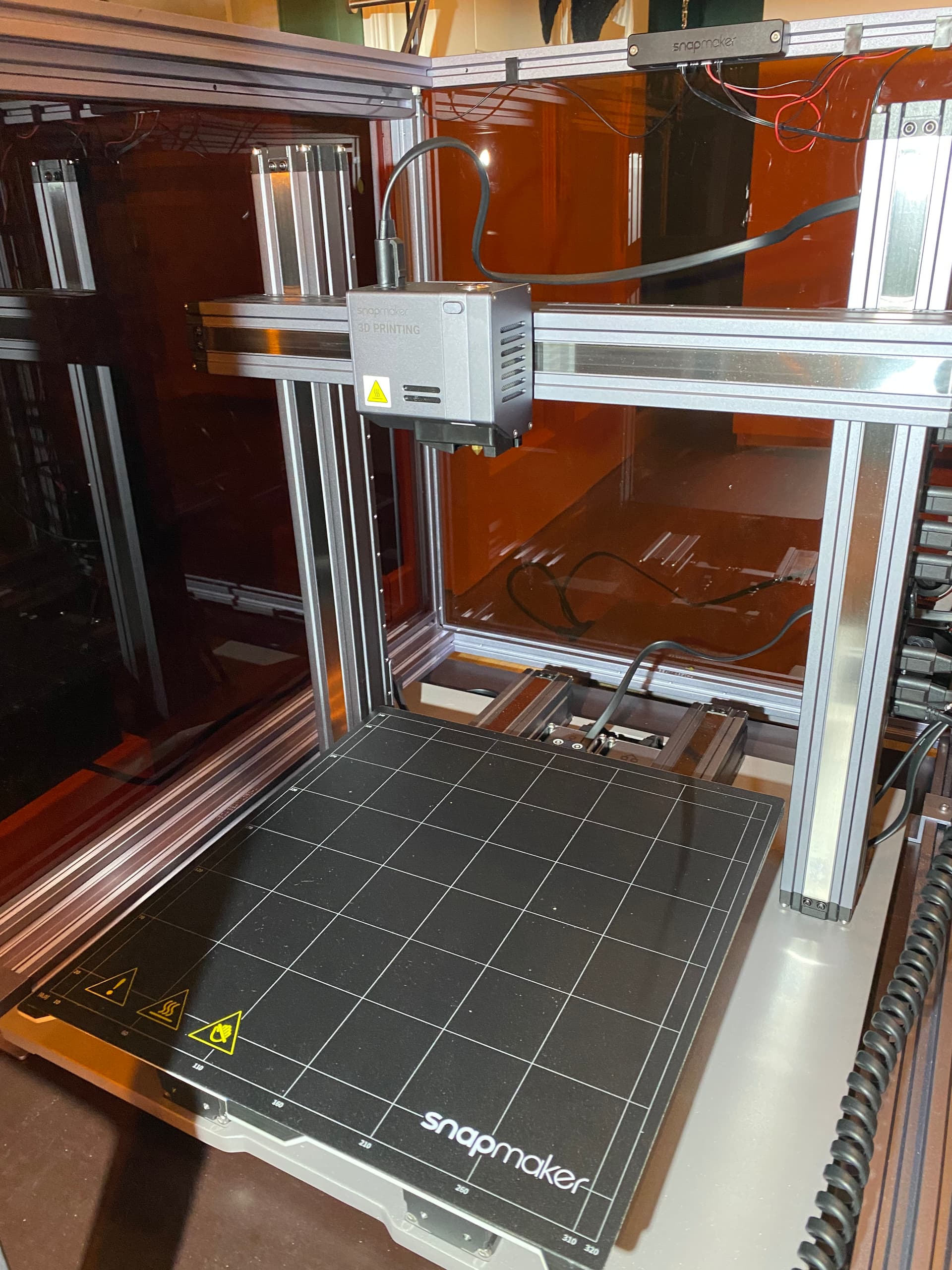

However, there is definitely something not going as expected as the listed work area on the screen of 150x150x150 is definitely wrong.
So, this might be a good time to log a ticket with support in case you haven’t done it already. You should reference this thread in your ticket so they don’t make you do every step again.

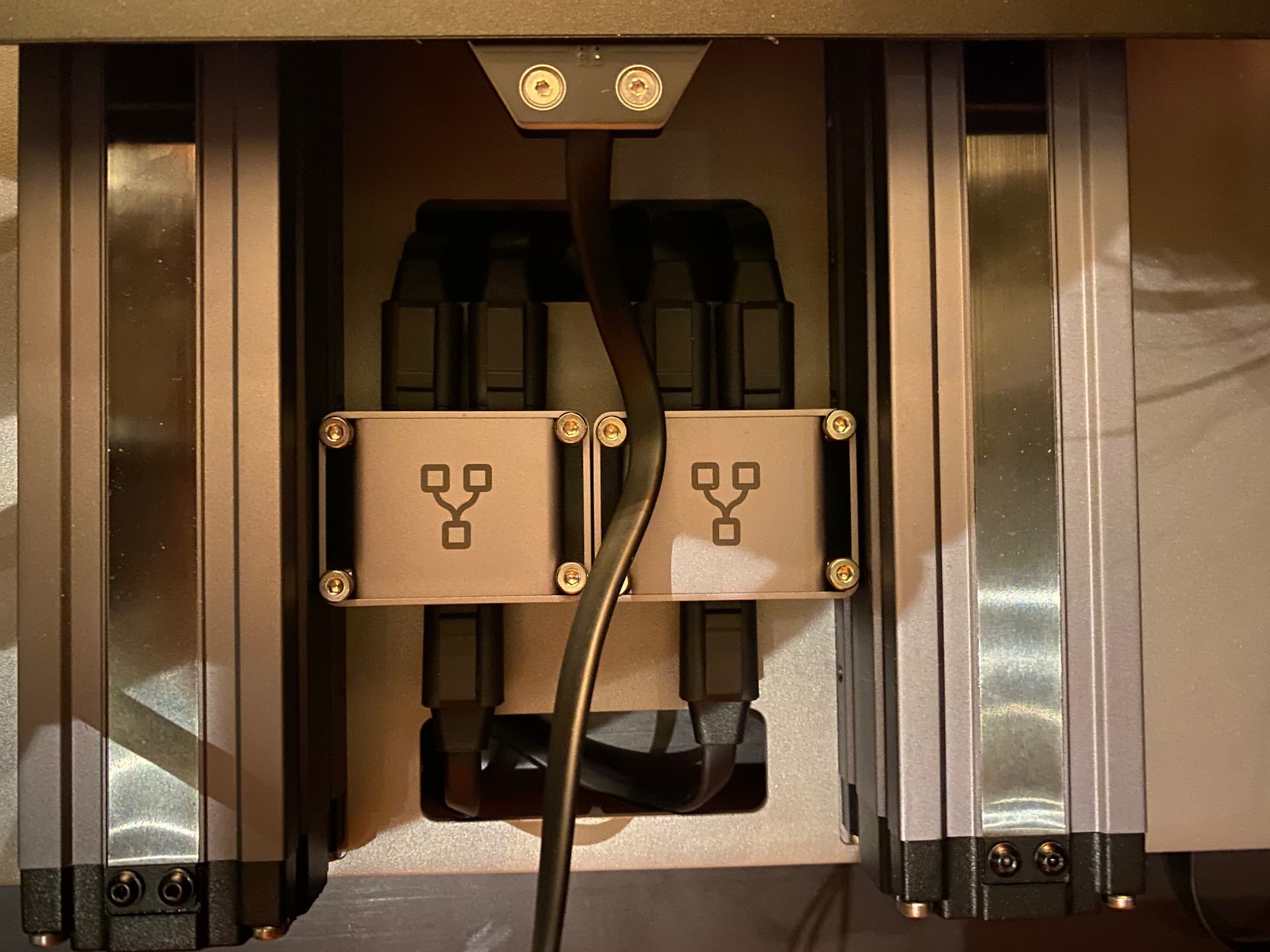

Assuming your cabling is correct there can be different reasons for this problem.
  • a problem with the controller itself
  • a problem with one or more splitters (the things between the two y-rails
  • a problem with one of the linear modules (for example a limit switch that is stuck)
  • problem with one of the cables
  • probably other causes
Maybe someone else can come up with things to test

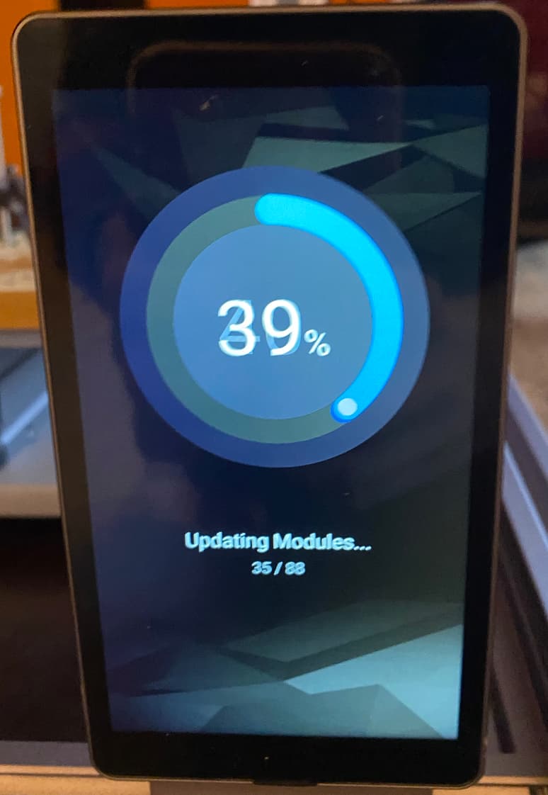

On older firmwares the solution was to plug in the cnc or laser head (with power off). Don’t have to actually mount it. And then it wouldn’t force you to do the auto calibration like it does with and you could update firmware.
Unfortunately the F… versions only have the 3D-printer module, so no chance to change to CNC or laser.
Seems to be, that I solved it. It is possible to update the firmware to the new V1.14.1 version. For the F…version I just disconnected the printer module and turned the machine on and it was possible to access the menu to change the firmware which I first downloaded here:
Snapmaker 2.0 Firmware Updates and Downloads - #18 by Alan and following the instructions.
After 5 to 7 minutes the machine was updated, I turned it off and connected the printer module again and the callibration process started fine.

The support got back to me and asked for the booting log. In the following I got informed that the Z and Y axis seem to be disconnected compleatly. I was told to check the cabeling again.
This time however I decided to clean each plug with my air compressor (I use that for ceaning my car or my air brush). Then I plugged everything in again. And the printer started working just fine.
