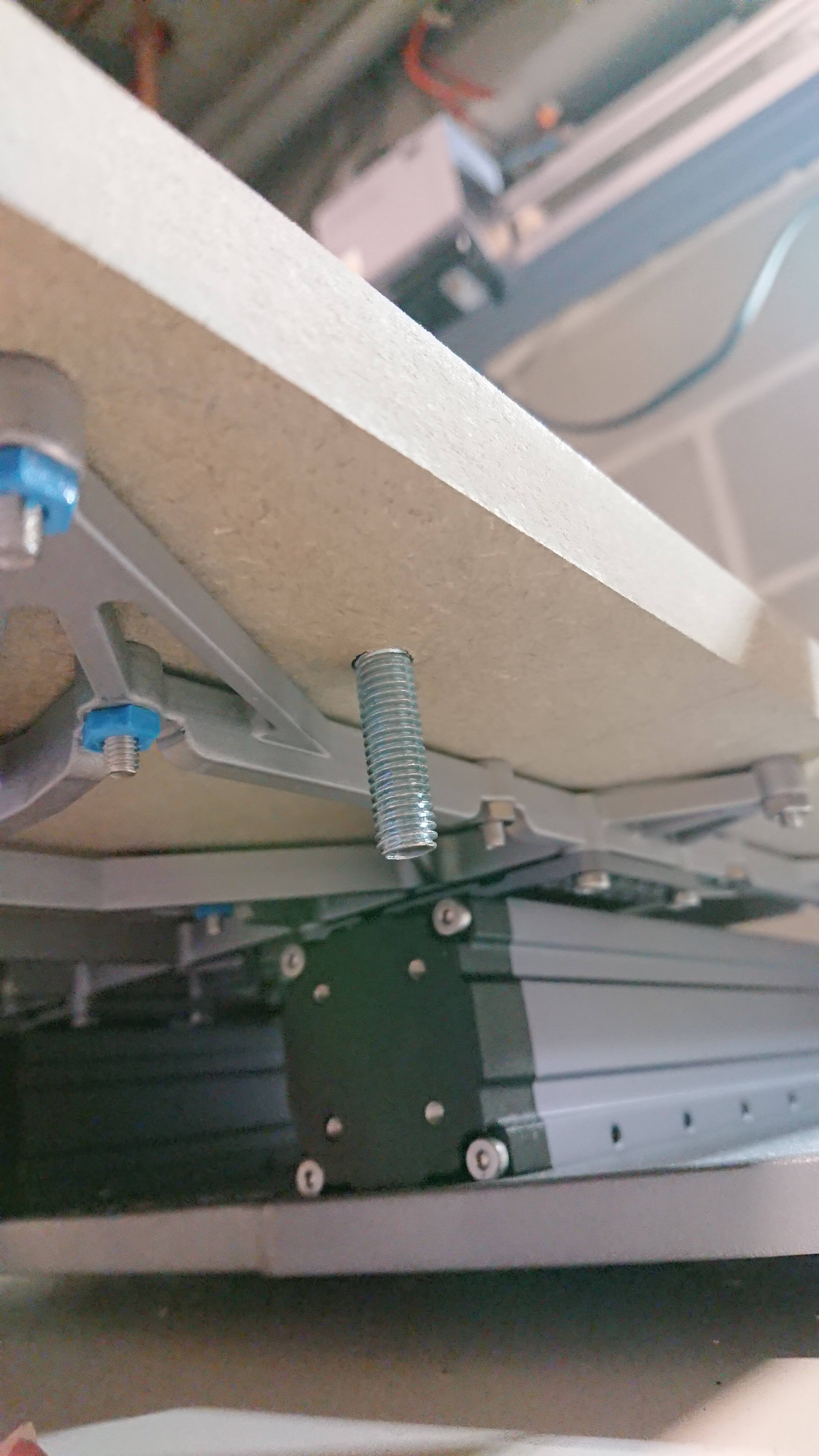

Finally some updates from my side:
I have been tweaking the model a bit more and cleaning up the openscad code a bit. I intend to have it online on github soon. Mostly to make sure I do proper version tracking for myself as well :wink:
It came out pretty well (on the right hand side you can see that the toolhead doesn’t reach far enough to make the cutout of the handle. Left and back work out just fine. The front just falls short but you can easily break out the remaining piece.
The good news is that all holes align up perfectly (yay!). I did do a quick test by running a calibration with the 3d print heat and just the sheet on top of the wood and it looks pretty good. There is still a deviationm but the surface is flat, just tilted. (hence the idea of machining it flat. Or this board could just be shimmed.
I modified the through holes for the carriage bolt so I can fix those to the build plates with a washer and nut from the bottom as well. (in stead of just having the hole there. Should make installing easier.
And as they say: measure once, cut twice (or how exactly did that go? :innocent: )
The location of those through holes is actually ok. It’s about 7mm away from the carriage. Which is ok for a normal bolt, ok for the type of clamps I first intended to use there but not for the wing nut I wanted to use for initial testing.
Nevertheless, good enough for a first iteration and doing some more testing with it.
But because magnets are fun, and it would cooler if I didn’t need screws/clamps at all, I finally did order these (pot magnets):
25mm diameter and supposedly 18kg of pulling force.
I chose those with the threaded barrel so they can easily be adjusted in height if needed. (and to prevent having them glued in place and just ripping them out every time because the magnet is stronger than the glue.
combined with these:
because they have a small border, that will prevent them from sliding away.
I figure that 3 or 4 of those magnets in the base plate should be enough to keep it in place.
Or maybe even already impossible to remove without a crowbar :sweat_smile:

I have used those brackets before and there is a bit of slop in them - to get them to work in this zero backlash way I think is possible, but will require careful design and CNC so that inserting them puts them in increasing tension and pulls the work table snugly onto the base. I put some additional notes above.
I think you’re definitely capable of doing that and I think the tolerances would be looser than what you’ve already done with the X inserts.
There may be a clever way of countersinking them just slightly too deep and using the attachment screws (and maybe shims) to control the tension. Getting adjustability into this, without introducing something that will loosen over time, will be interesting.
If this is expected to last a long time and maintain adjustability I’d be concerned about the wood screws provided in MDF - it will chowder out the screw hole eventually. If this was my build I’d use threaded inserts from the back (T nuts probably) with thread locker and a machine thread - at least on the base since it is “permanent” and will see more wear than each tool plate.
Dialing in the adjustment, in my head, would look like roughing in the height with shims under the brackets and repeatedly test fitting the work board, adjusting the base screws and shims until it’s perfect. Then, since the shims under the brackets control the height, apply threadlocker and tighten the screws down.
The slop sounds like something a hammer could fix :wink: but doing the mounting carefully could probably eliminate most of the issues.
It could also be an option to place them in a circular orientation, so that you turn them in place. Similar to what some light fixtures use. As you turn, it pushes both sides closer together That might help as well to get the tolerances in the fit to be less of an issue. Last weekend I struggled a lot to get it loose from one of my wireless access points :wink:
It’s a snap fit, so it’s a bit loose at the end, but the “snap” part isn’t necessarily needed here. Although I’m not sure if it would add that much value and I’m just overengineering again.
Exactly. That’s also the reason why I’m using the carriage bolts in the initial idea; to keep them locked better (and obviously avoid them to turn around as they are tightened from below.
Now my main challenge is to find the correct name in Dutch for these things to find a local store/supplier where I can get these things :face_with_monocle:
The dowel/pin part aren’t the perfect solution as you would need access from above (and the having everything premounted is kind of moot). But maybe the box lock type of latch could be used somehow.
Edit:
An extra advantage is that you can just hang the plates you’re not using on the wall so they are out of the way! :partying_face:
These might be an alternative for the rockwell brackets as well. As they connect there seems to be a slope so that they are actually pulled together. They are significantly thicker though:
https://www.amazon.nl/gp/product/B07R4N2STK/
But they do look sturdy and like they would last.
I quickly created a small 3d model of these to test the concept before I put in an order. (not an exact replica, but similar design) That should give a good idea if it could work. A3d printed model might even be good enough if if it is countersunk in the plate and all snug in there. (model created with a tolerance of 0.1mm for) Not yet tested/printed. That will be for another day.
preview:
slide-connectors-hook.stl (409.1 KB) slide-connectors-sink.stl (305.9 KB)
(to be printed standing up for optimal strength)
