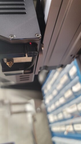

I am having the same issue as the OP. Auto level goes to the first point and it continues moving down smashing into the bed. I have tried several firmware versions with the same result. I can see the light on the sensor but it doesn’t seem to be working. I will be trying a manual calibration and maybe I can get it printing again. I had been printing really good for weeks already and just out of the blue the print messed up and I found this issue with the auto leveling.
Does anyone know what type of sensor it uses? Laser proximity, magnetic?

When you do an autocalibrtion and put a piece of metal aginst the sensor, then goes the red light on, or is it ever on?
I suspect you work with the standard printbed from Snapmaker?
Well from what I can see that red light is on all the time. Here it is sitting at “home”

Sensor is bad if its on continually.
you will have to contact snapmaker support or rig up your own solution, NPN normally open or a contact switch between gnd and sig
you can manually calibrate in the mean time.
they are on chinese new year so its gona be tough to get anything fast but they do seem to have a little bit of manpower still.

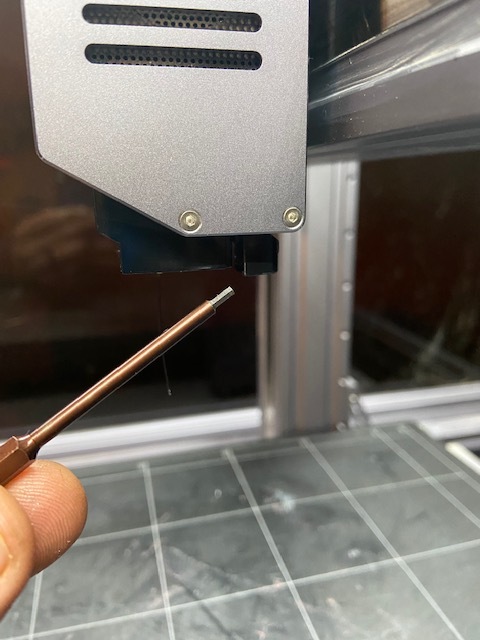

This happed to me after over 1500 hrs of printing. After reading these post I took the print head off and found that the sensor had been dislodged and pushed up into the head from its original position. There is a bolt head located in a slot that raises and lowers the sensor. I reset the sensor all the way down to the bottom of the slot. Once I did that, it calibrated without jamming into the print bed. When the sensor is set up correctly, it is a little lower than the area around it as shown in this picture. Working great now.
Hope this helps someone.
I recently had that issue. Mine turned out to be some hair-like filaments around the black rectangles by the nozzle (IR sensors?). Once I cleaned them everything works just fine :blush:
