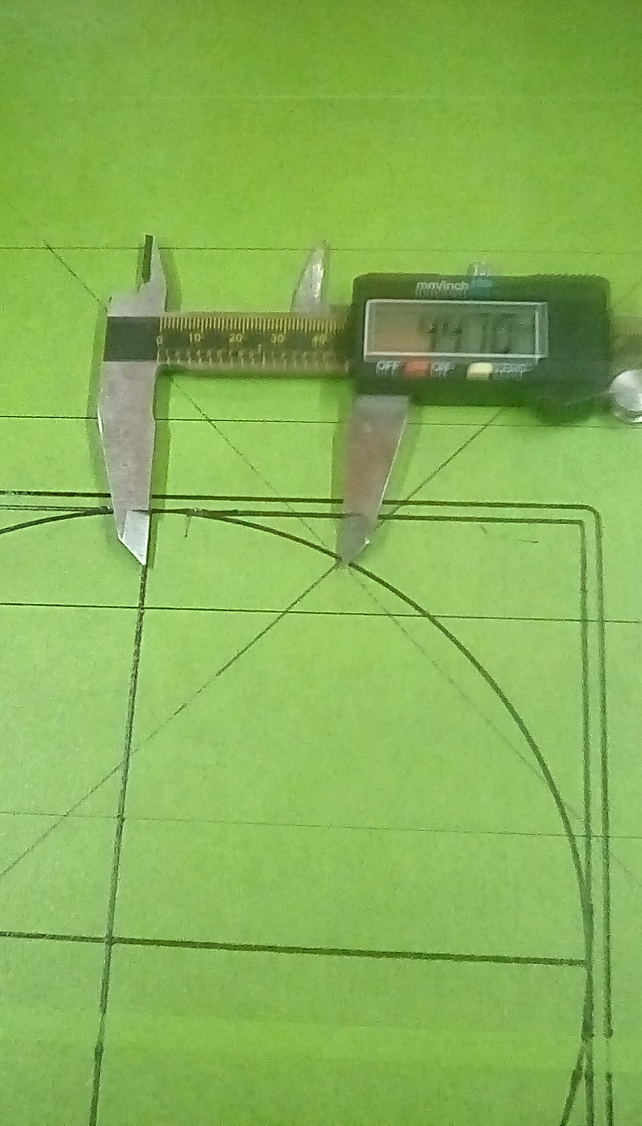

X-Y calibration test need help badly
this was done on a cold machine this morning . after running the 3d test v4 “torture” test last night that I downloaded from the forum.
I made an earlier post about this same problem but found issues in with my fusion design . and i thought it was fixed . but obviously its not
Im going to pull the plate and check if the linear Modules are synced and aligned. like in the troubleshooting guide .
I am really at a loss here i’d like to have checked everything before i start a ticket with support.
any help would be much appreciated.
x-y calibration from extensions in cura.gcode (1.1 MB)
3d test v4.stl (120.7 KB)
Sorry , it was an x-y calibration test from a cura extension that i ran first and i ran the cylinder after getting the bad print.
The alignment on the y linear modules is perfect
