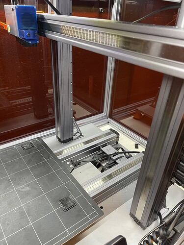

Hey yall,
ive searched around and havent seen a solution to the problem i have been having.
My build plate was installed correctly, and my settings look correct, but all my prints are off-center by about 20mm left and 20mm front.
I checked the assembly, all aligned and proper
included are my configs and images. Anyone know how to correct this?
Firmware 1.11.4_20210201
Cura 4.8 -
Please post some more pictures. From the front and from the side so we can see more of your machine.
Was it so from the beginning or is the problem new?
I can’t actually remember if it was working right before the latest firmware update. I was printing on glass but had to put it all back stock. Now I’m trying to diagnose this problem before I go back.
whats that blue thing on your 3dp module?
can you jog 100 percent of the axis in question? maybe a switch is being triggered prematurely? and therefore the machine isnt where it thinks it is?

@gspeed its weird can not see that there is someting wrong with the assembly.
@MooseJuice The blue thing is Tones? probeholder I think.

And another question: Where dit the printhead start? At X-10 Y-10 like you start gcode shows or is it at this point alreaday at X-20 and Y-20?

  1. yeah i made absolutely sure the assembly was correct
  2. blue thing is a calibration probe holder, i took the probe out for the moment
  3. yes i can jog 100%. 345X 355Y max right max front
  4. yeah my settings are from this GitHub - Kaouthia/Snapmaker-2: This is my archive of files for the Snapmaker 2.0 A350. At the moment, that primarily means my Cura 3D printing profiles. In the future, I may add profiles for other slicers, and possibly CNC and laser related files, as well as potential upgrades you might want to print to improve the features of your Snapmaker 2.0. but the effect is the same using default snapmaker settings or these settings for printhead
  5. my extruder settings
  6. printhead starts at -10X -10Y the “offedge” purge, no problems there
