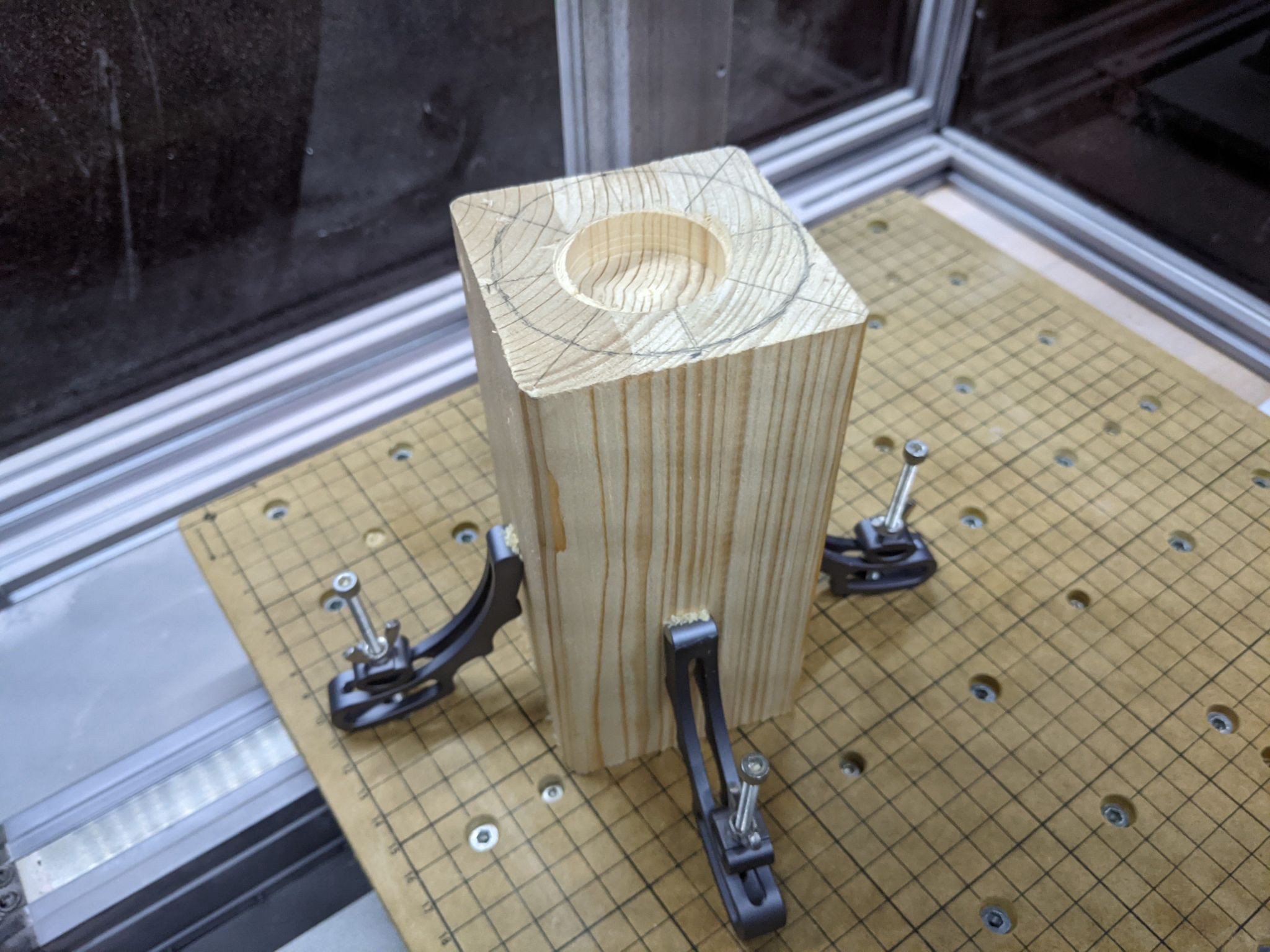

The model I’m doing is still the same owl as linked above, but instead of a weirdly shaped block of material, I’m actually starting from a square 7.4 cm x 7.4 cm block that I cut to a length 15 cm to fit into the rotary module.
I marked the center on both sides and the circle with diameter A in which I want to carve the model, and measured the maximum diameter B (10 cm) and the diameter A (7 cm).
For attaching this block to the rotary module I decided to drill a big centered hole (3,5 cm) in one of the sides, so I could use outside clamping.
After an unsuccessful attempt with a forstner bit (mostly due to the lack of a drill press) I realized that I had the perfect machine to make this hole at home already, a Snapmaker 2.0. And so with some creative clamping and a pocket tool path, the hole was done in about 10 minutes.
With this I was able to clamp my piece of wood into the rotary module, and to keep it stable I attached the tailstock as well. And in this position the material would remain until the end of the project.
