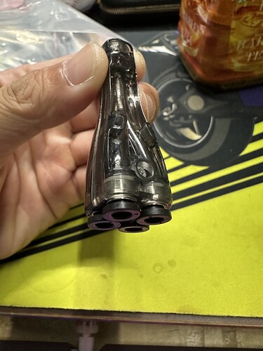

One of the fittings on this multi-port manifold has detached from the body. I’ve reattached it, but I’m unsure about its long-term stability, so please use it at your own risk.
