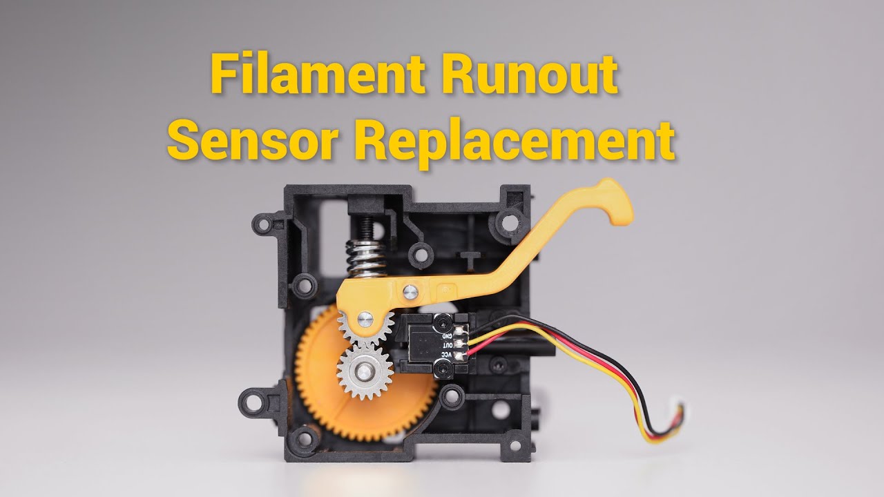

U1 Video Guide: Filament Runout Sensor Replacement
Hi U1 Community,
We’ve released a new video showing how to replace the Filament Runout Sensor on the Snapmaker U1. If the screen still shows No Filament after loading, or Loaded after unloading, the filament runout sensor is likely faulty and needs to be replaced.
What the video covers:
  • Part 1: Removing the toolhead (unloading filament and detaching the toolhead).
  • Part 2: Replacing the filament runout sensor (removing the extruder unit).
  • Part 3: Restoring the toolhead (reassembling and parking it).
Watch the full video to follow along, and feel free to ask any questions in the comments!
