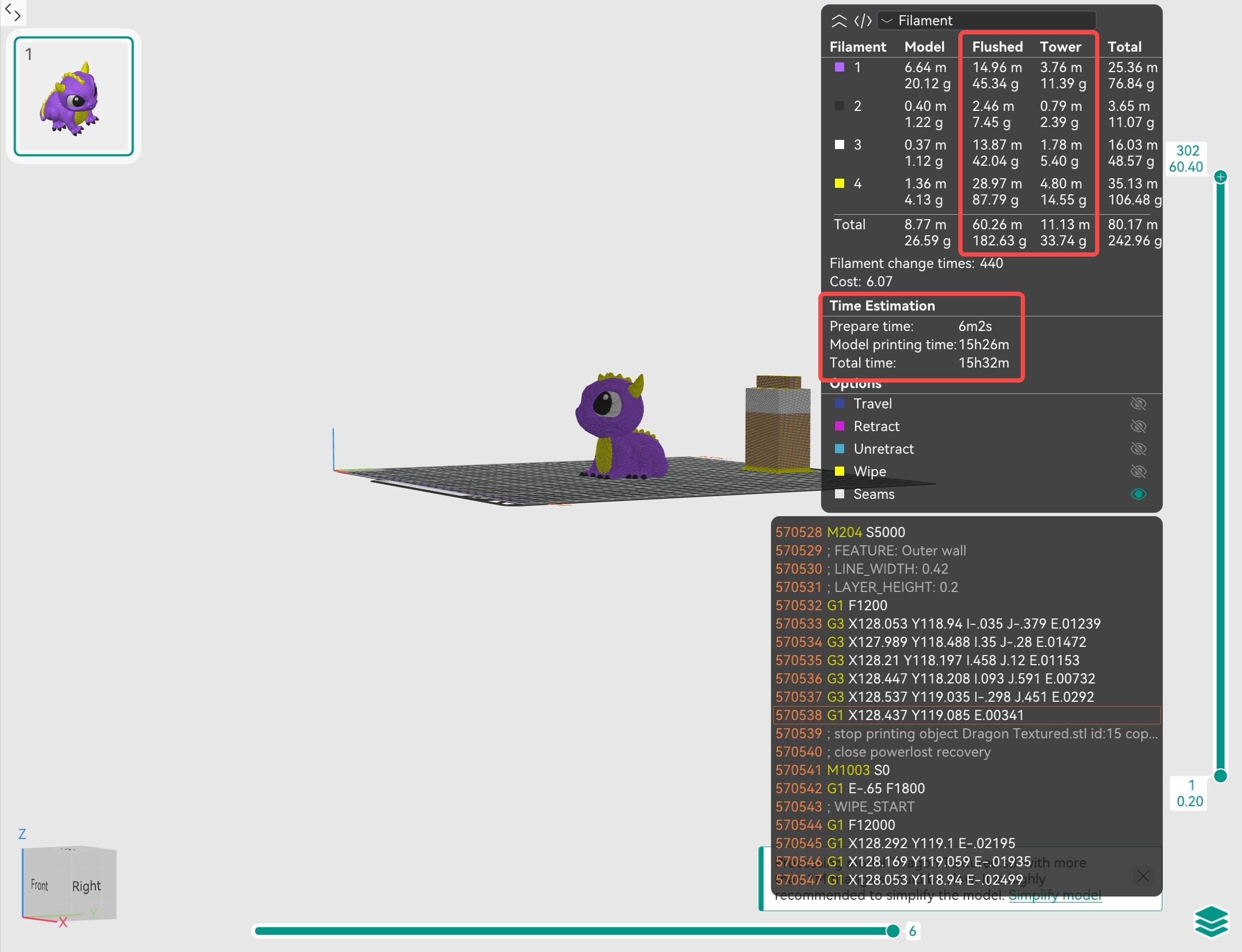

Here’s what I got with one 4-color Baby Dragon:
  • U1: 2h39min, 12.54g tower
  • Other printer: 15h26min, 182.63g flushed + 33.74g tower
  • Model creator: IK3Digital

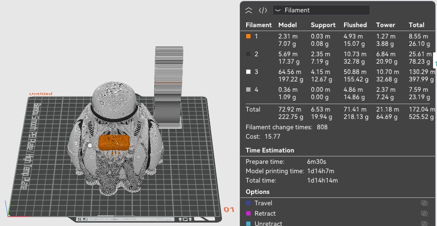

Bambu X1c 1 Day 3 Minutes
Snapmaker U1 16 Hours 40 Minutes

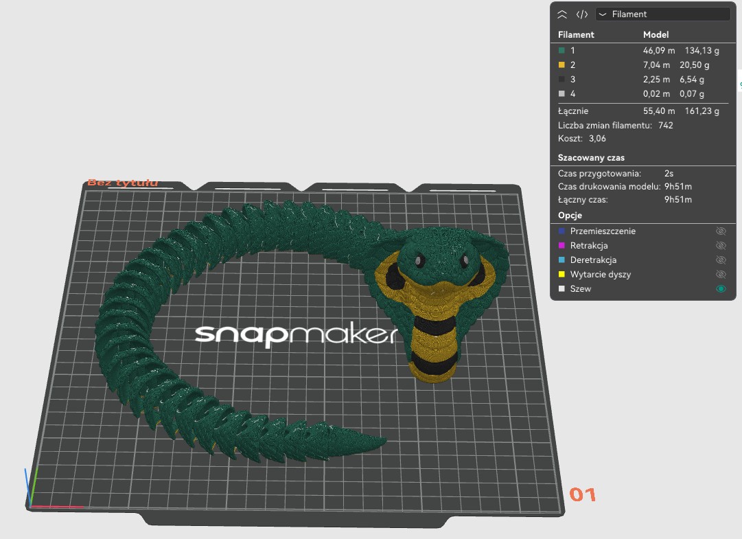

**Cant post pictures due to being a new member
However Pictures are posted on the facebook group ( In Comments )
P1S( Top ) Vs U1 ( Bottom )

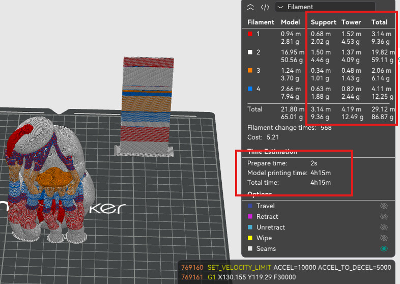

The first model I tried actually showed an increase in the print time over my X1C, but something did not seem right. I chose a new model and the results are astonishing in terms of time saved and even greater in filament saved.
Model: Stay Puft Rubber Duck - MakerWorld
The model was printed on the Anycubic Kobra S1,
now sliced in OrcaSlicer - the same parameters for both printers.
AC Kobra S1 - 37 hours
Snapmaker U1 - 9 hours

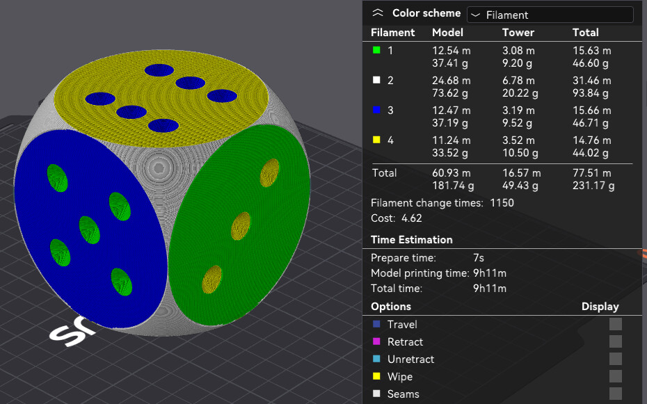

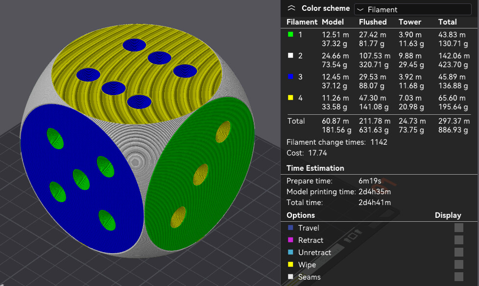

Here’s one! A very multi color, 6 sided die design I’d love to print oversized for my buddy’s kiddo. Slicing it here for an 80 mm cube with same speed/quality settings.
A1 Mini + AMS Lite: 52.6 hours, 886 grams
Snapmaker U1: 9.2 hours, 231 grams.
5.7 times faster and 3.83 times less filament. And this is precisely why I don’t have an AMS, though I do have an A1 Mini. I just don’t have 2+ days to keep an eye on a print.
Filament changer:
Snapmaker U1:
Edit to add: This one’s my own design.
Edit to also add: I’d like to disqualify myself from the drawing as a beta tester who’s already monkeying around with a U1. Just doesn’t seem fair. :sweat_smile:

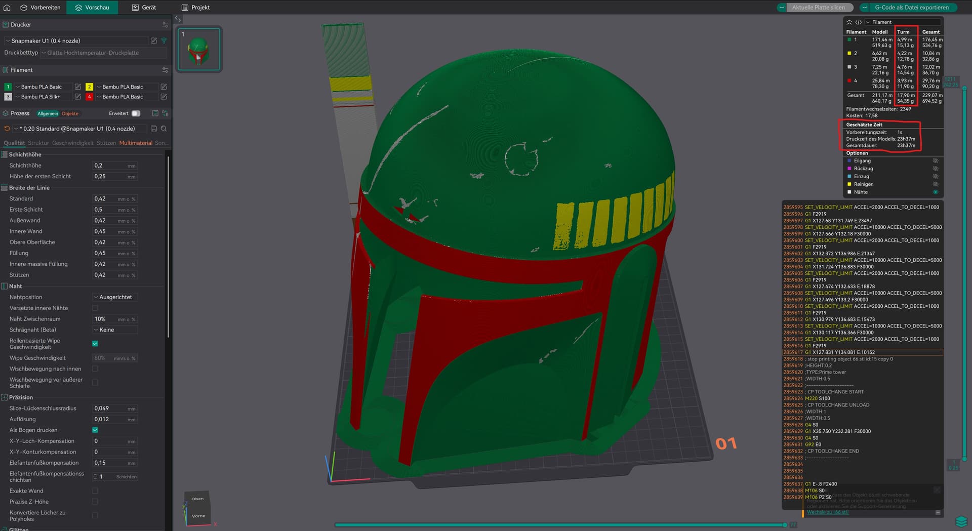

I thought I could try a really demanding painted model. I painted the boba fett helmet from makerworld (https://makerworld.com/de/models/53278-boba-fett-helmet-supportless#profileId-55044) and sliced it first with the U1 (first picture) and then with the P1S (second picture).
Incredible! I don´t know, if I would really print it like this, but with the U1 it is promising to do so :smile:
