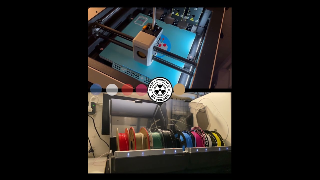

i made a fork of /BlackFrogKok/SnapAce named mUlt1ACE.
Integrates 1-4 AcePro with fully automated hotswapping. No inprint change so far, but we’ll see.
Runs on stock, Solderfree Adapter instruction included.
Still Beta, but if anyone wants to try

Hi, at the moment i am aiming at the hot-swap approach so each head is connected to the same slot on each AcePro. So you can have a set of filament in each AcePro and wap between them. But my current developer build is able to laod each head from different Aces.. and can do single layer color swaps.. I’ll post a video later..

In my mod as well as in snapace you can set the retract speed for the acepro. In the video it was on snapace default 80. It gets better when you lower ist, but its never perfect. I don’t think its a software problem, you set speed and retract, can’t imagine what a Kobra does to prevent this… But i printed an upgrade part that helped with the filament leaving the spool and some other Ace problems, like low weight spool try to lay down and bock… 2.0 Anycubic ACE Pro Upgrade Kit ( to new S1 Version) by Gwebster | Download free STL model | Printables.com
New Version 0.80b “First Light” is out. cross Ace Filament usage
New Version out, supports color swaps during print.
https://youtu.be/JauKpkZ0omY

Hi, thank you.. I am not sure if the combination U1, ACE, tip forming will ever be reliable enough regarding color swaps to justify this step. The actual live version can already print with 16 colors, just using the post-processing script. But the swaps fail every now and then, so you have to fix and resume then. And i have to fine tune priming.. And swap times are just like when you would do it manually… But maybe, lets see what the future brings, ACE 2 hopefully :slight_smile:

  2. I did not change the print routines, the software basically handles the load and unload before and mid print. So from its point of view the things that can go wrong are unloading, loading and extruding after load..It repeats failed steps and if all (cfg changeable) repeats did not help, the printer pauses, just like without multiace. So i see no reason for a shutdown on that side.
  3. No problems with a collaboration, but if you want you can upload your full spectrum sliced Gcodes and print in more than 4 colors. You just have to set colors an materials according to the ones used in the slicer, it matches to print colors by hex, name and so on, but hex works the best of course. I will make it selectable later.
Just the color swap times are around 90sec, so i would not recommend hundreds of them, time and poop-wise (still less poop than a single head printer of course)
