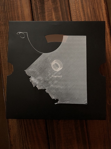

I tried to print the Snapbox after assembling my Snapmaker yesterday, and after about 40 minutes, it looked like this:
After recalibrating the printer, I ended up with similar results again.
Has anyone seen this? Is this actually expected and I should have let it go for longer? I didn’t pay attention to the estimated time to print and just saw from the previous messages that it would take quite some time.
Thanks!
It looks like your calibration is off. The fact that the print is getting too thin to print at the left lower side tells me that it’s too low there (corner 4?)
