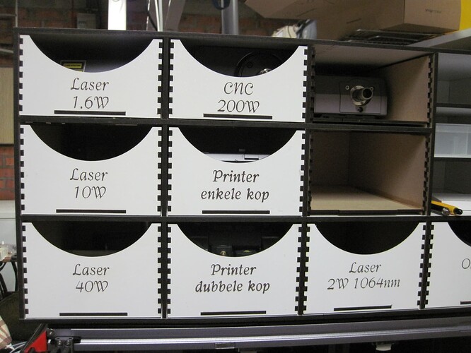

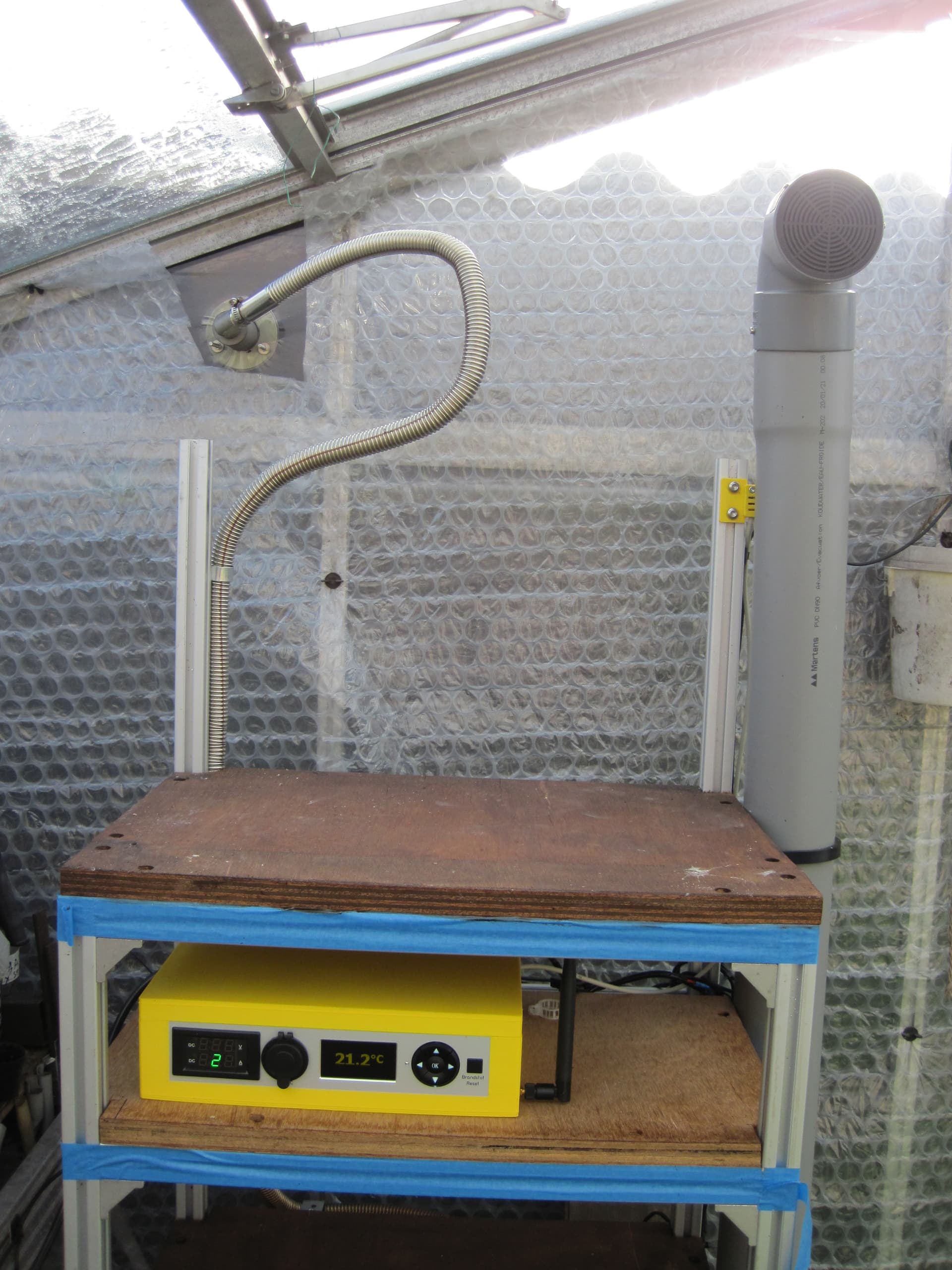

That the SM 2.0 can do great work, you can see at the showcase pages. But like all of these products there is a learning curve. I have another CNC milling machine too. That doesn’t works from the first time. I think about buy a Sorotec milling machine (to mill alu). I’m 100% sure that the first try not the result gives that I want.
This is printed on the SM2.0. The whole
Made with octoprint on a raspberry pi. Draw in sketchup.
With the 40W laser and Lightburn on a laptop. Draw in sketchup.
2 faces to mill. Made from 5mm and 3mm MDF.
