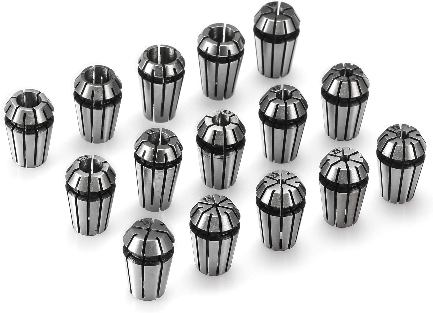

For CNC bits I recently bought a set of er11 collets that range from 1mm to 7mm also with a 1/4 and 1/8 bit from amazon:

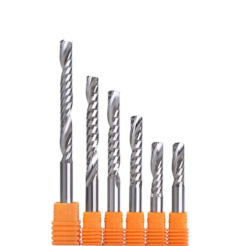

And also a 6x6x62 for my rough cuts:
Both of those bits diameters are 6mm so they would go in the 6mm collet, there are a plethora of choices as you have found out, it also depends on the job you are trying to do, as the examples above are what I would use for relief carving with the flat end mill as the rough, and the tapered ball nose end mill for the finishing pass. If you have anymore questions feel free to DM me.

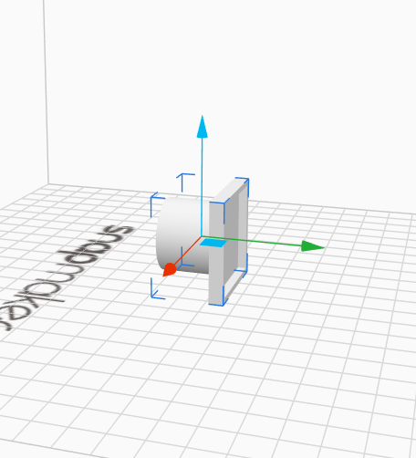

Here I offer you a converter model with which you can put the material on the chuck. You can glue the square material on it.
You need to calculate the radius by yourself.
square2round_converter.stl (45.7 KB)
Thank you, Edwin. 3D printing the converter is a great solution.
It may need some patience to carve the square materials with the rotary module. You need to calculate the diameter of the outer circle of the square. The whole workflow is the same as the one with the cylinder material.

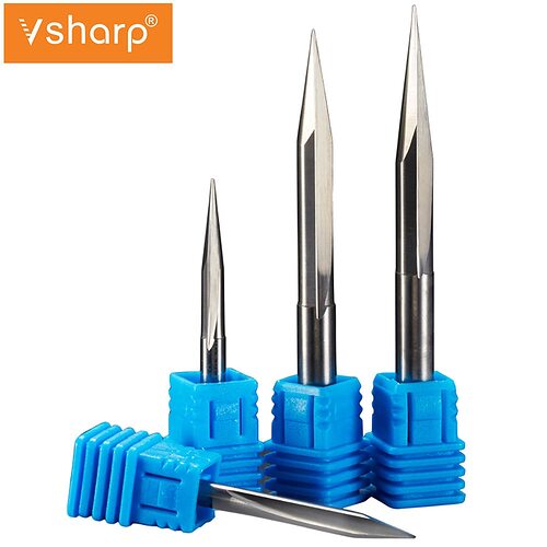

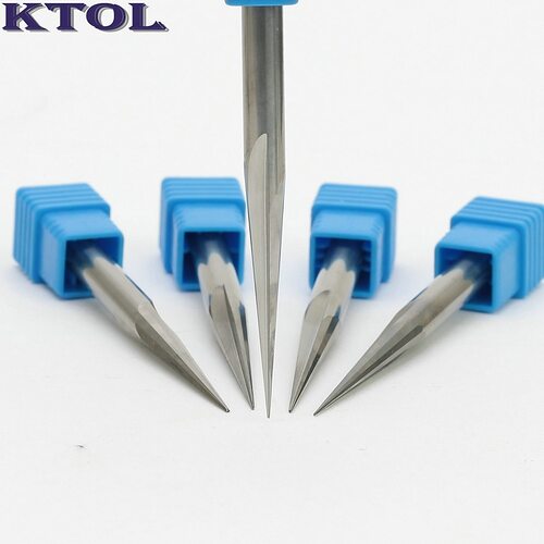

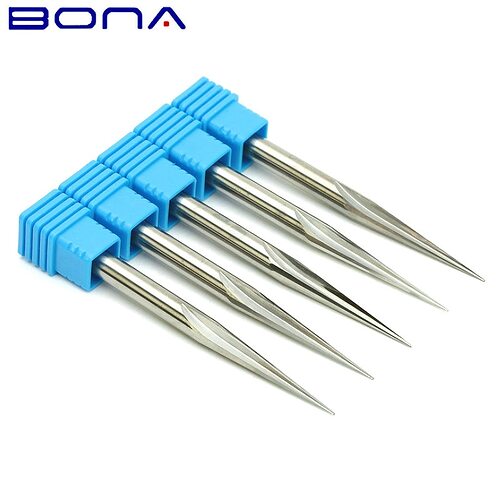

@herbweiner Yes I am using them for the 3-axis, for the 4-axis I am a little new on, it would be great if you could do a rough pass then a finish pass for the 4-axis don’t know if it is possible as I only have the free version of Fusion360 and I believe to be waiting on the files for importation to Fusion360. For the bits I seem to have tracked down a couple however if I am not mistaken they would require the collet pack mentioned above.
