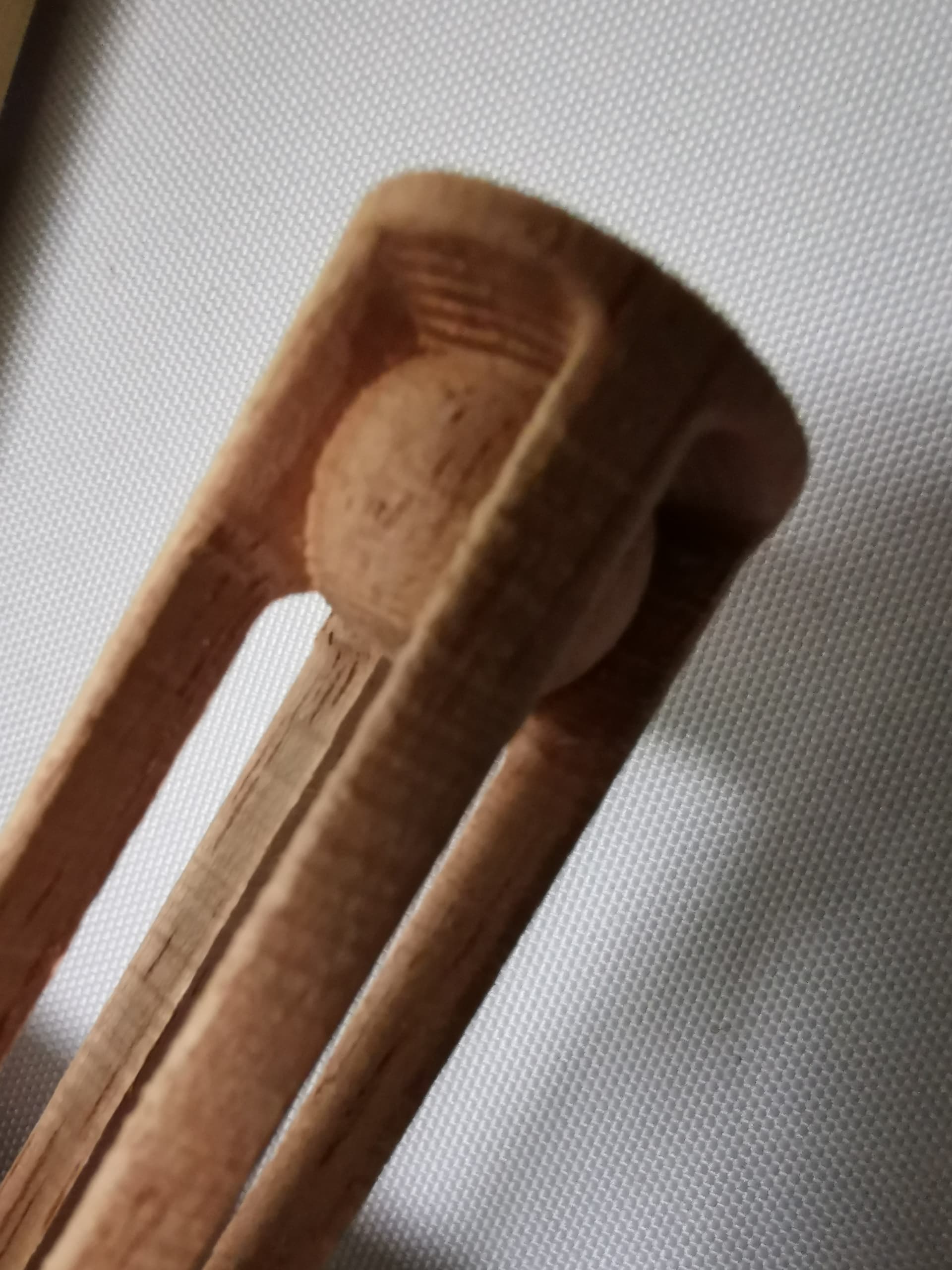

I’m just trying a Linkage job from Luban on a ‘ball in a cage’ stl file from Thingiverse, looking good so far, I’ll report my findings here tomorrow when its finished. I know Luban is not really free, its part of the purchase but I don’t want to shell out more money unless I’m sure it will take me in the right direction. I thought I had enogh expensive hobbies with photography and electronics, seems like this one is just as bad. :rofl:

Will do. Here’s a quick video of the action. As you can see, the overall diameter of the bit isn’t accounted for as the bit moves down into the work. This means that material may be removed where it shouldn’t. Still some way to go before it gets to the ball - the really interesting bit. it might turn out square
. :slight_smile:
Close but not close enough, the ball is trapped.
I used the standard settings for the straight groove v-bit as supplied but changed the shaft dimension to 4mm to suit the bit I used. It does suggest that the toolpath created knows it cannot carve a gap less than the shaft diameter. I’ll design my own model with a bigger gap and try again.
It seems that the program does not make automatic tool compensation
I also found the same problem.
Agree with you!!
