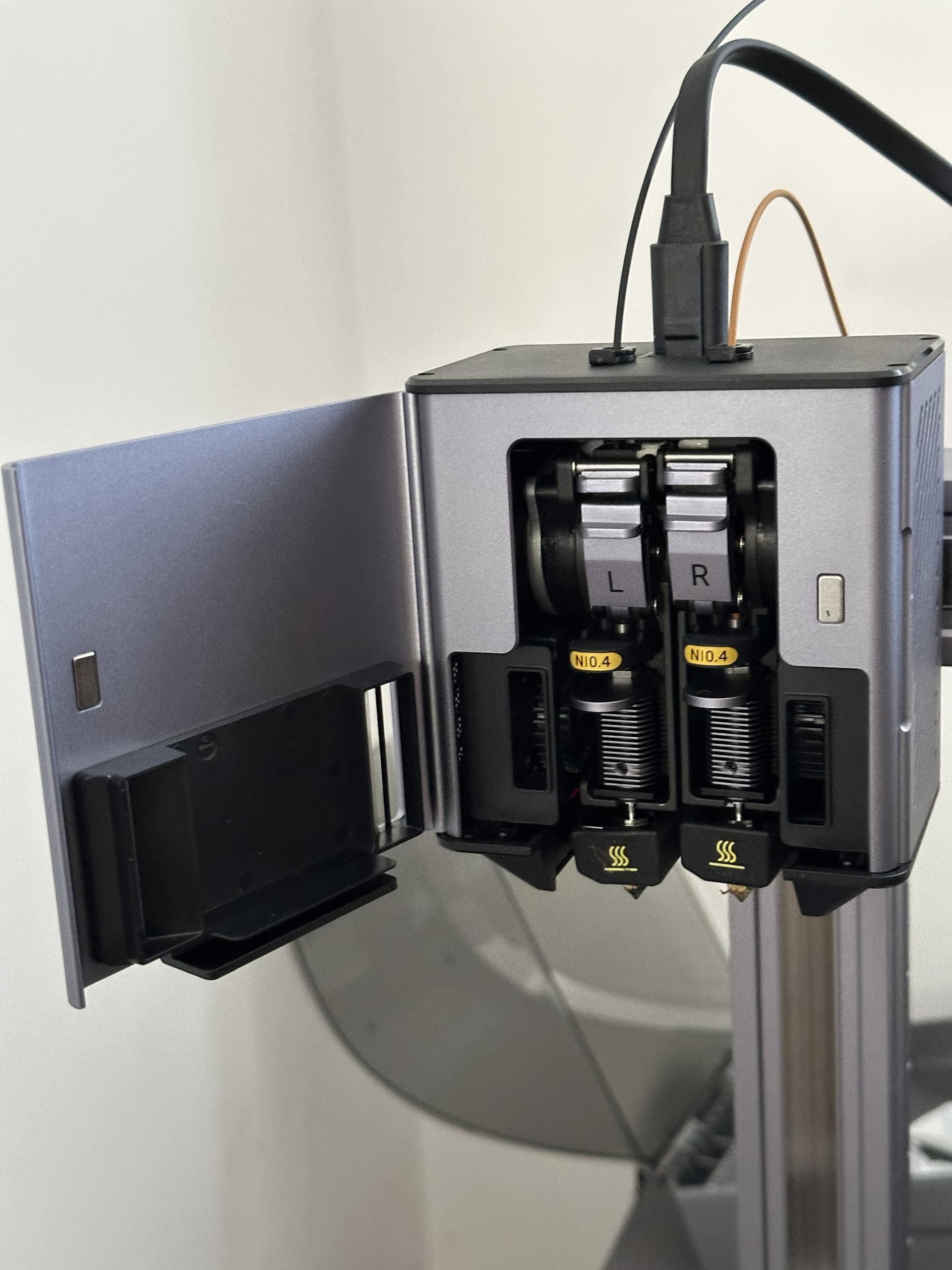

Had the dual extruder head sat in a box for 2 years (delivered Aug 23), just installed it today. What a disappointment, mostly makes an oozy mess of almost anything, or knocks the tower over and fails. I’ve had 1 successful print out of 5.

Send us a picture of the dual extruder (especially the door), so we can get sure you have the latest hardware design.
Thanks, the mess is in the trash already! but next time I’ll take a picture
Here’s some pictures of my dual head, installed on the quick swap with the original linear modules
Search in your emails for coupon or reach out to snapmaker so you should be able to get a free replacement/upgrade kit:
This should help to prevent heat creep, this and defective runout sensors were common issues with the old design.
No the hardware side should be cleaned.
Waiting for some pictures, showing print defects :wink:.
thanks so much, I’ll give this a go! Will wait for this mod before trying to print again
