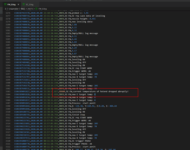

Try to generate export log file and upload it here if you can
Here are the logs:
The current temperature of the hotend dropped abruptly. Did the value of the temp drop when it froze?

The reason for this topic is various. I found that one of my colleague likes to use cable ties to tie the cables together. When the machine is working and the printing module is moving, the movement can lead to poor terminal connection.
With the command “M2000 S0”, we found that the executor was lost during the printing process.
The machine works well after we plug the tool head cable correct and untie the cables.
