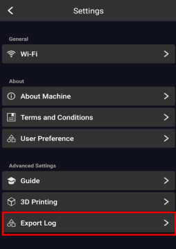

We may need your log files from the touchscreen to troubleshoot. You can export the log files from the touchscreen and send them to me for further analysis. Here is an image for your reference.
When this issue happens again, you can connect the machine with your PC and use the command “M2000 S0” to check the machine’s status.
Dear friends. Thank you for your fast answer. I am so sorry, it was my mistake, i wasn’t updated software, after updating i haven’t problems with my sm.
