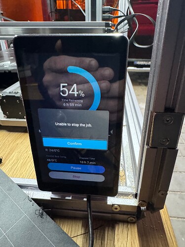

Help, unless someone can actually tell me what I am doing wrong (instead of Snapmaker Support just Kicking off links to me), I am done with Snapmaker!!! I consider myself to be a very patient person. I have spent months trying to get the snapmaker 2.0 3d printer to work without success (even after upgrading to the dual extruder).
As you can see in the attached images, the Snapmaker 2.0 3D Printer just does not work. I lose 3 out of every 5 print attempts and the print quality of finished projects are terrible. This is the second extruder to fail and have a complete meltdown. The continuing support tickets keep sending me links for varying the extruder/bed temperatures or claim I am using substandard filaments.

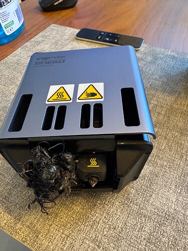

I have submitted multiple tickets for assistance and trouble shooting. The Dual Extruder already had one meltdown and Snapmaker sent me a new replacement extruder (after I chisseled out the first one). However, now the entire dual extruder casing is melted to the PLA blob that has congealed around the entire base of the dual extruder (now a very ugly and expensive paper weight).

Seems to me you have adhesion problems and it’s nothing to do with the heads.
This is one of the most extreme cases of warping I’ve ever seen - wow! Are you sure you are printing with PLA? I only have seen this with PETG before…
Whatever, it seems that you have really bad bed adhesion, and potentially some drought that cools your prints inadequately. The bed adhesion thing seems from your pictures partly be related to your print bed being uneven, which unfortunately is not uncommon with the A350 printers. Several workarounds exist:

I’m experiencing the same issues with the dual extruder. I’ve been using it for about ten months and have spent hundreds of hours attempting to achieve a consistently high-quality print, without success. I’ve tried several filament brands, including Snapmaker, Sunlu, Polymaker, and Overturn, as well as different slicers such as Luban, Orca, and Cura.
I’ve attached a photo showing issue I’ve encountered, where the filament binds up during printing. This has occurred with PLA, TPU, and PVA. The attached image shows TPU at the point where it exits, but with PLA and PVA, the jams occur internally. On one occasion, the PLA was so tightly bound that I had to carefully use a torch lighter to slightly melt it in order to remove it from the gears. For reference, I have also tried drying the filaments to rule out moisture as a cause and even changing the hot ends out. This maybe caused when the nozzle bottoms out on a high spot.

my issues with this stemmed from a bad part. after the gear the filament slides into a tube. on one of my extruders this tube freely moved up and down that extruder always failed. the other extruder with this part solidly in place worked fine
