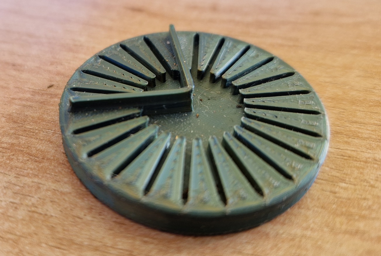

Recently my Snapmaker 2 with dual extruder print head has gone crazy. Printing starts OK but then something goes wrong. The surface is supposed to be completely flat. I am not sure where the artifacts are coming from. You see what happens in the photo. Eventually the print head hits this ridge. Any idea what is going wrong here? BTW, I tried to generate the gcode with Luban as well as PrusaSlice just to make sure the issue isn’t with the slicer.

Of course it’s only a guess. When I look at your first picture it seems that the print head scrubbed over the material. I had that issue a time with my (single) print head also. After calibrating the Z height using the machine itself it got a lot better.
Another thing is the temperature. In the gcode file it shows 210° for the nozzle and 60° print bed temperature. In case of PLA, try it with lowering both, i.e. 190-200 for nozzle and 50° for the bed. I would also set the first layer speed (better: first 3 layer) extremely slow. In my experiments these settings worked a lot better.
Too much heat on the nozzle can result in minimal clogging on the outside of the nozzle and this material can scrub over your model leaving “nice” artifacts. And the sensor of the print head can scrub over the material and rip off something then. Had that when I was printing over night and at the morning I had a big fat clump of PLA on the print head which hardened and the printer still scrubbed that over the heat bed with a sound you don’t want to hear from your printer… :slight_smile:

In the picture you see on the right side my PLA clump, the rectangle inside is the form of the print head and nozzle…
On the left side this was a test print with a multi-color PLA with too thick output and too much heat, which always resulted in bending up the middle part (which is the longest line length and therefore the hottest), the whole thing should be flat.
And in this picture it is the exact same model, printed with a very fine line strength (of course loosing the multi color effect) with better temperature settings.
Since the problem occurs with to different slicers, and the STL has no structure in it that would explain this effect, I’d also infer that this is something with the machine. My wild guess would be on the bed leveling - the cross-like shape is too obvious to be a coincident. I guess I’d redo bed levelling, potentially with a different pattern spacing. Also, I might try moving the print a few cm left or right - if the cross moves with the print and stays centered on the print, this would indicate that it after all is a slicing issue, but if the cross would stay centered on the print bed (i.e. offset from the object’s center), it would confirm that the machine misbehaves.

This looks more like a settings problem - my guess would be either printing too cold, or slight underextrusion, or a combination. It seems like the filament is not sticking well to the layer below and then warps.
The First layer was perfect? Normally this appears in too Low z or on overextrusion. To much Material which is squished next to nozzle.
That was what I thought first, but if you zoom in into the picture, you can see that it is layer lines delaminated and deformed, not squished material! Thus my assumption above…
