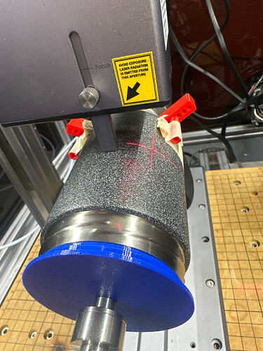

I’m having a really tough time trying to figure out what the problem is here. I will send the file, calibrate the focal point, set the work origin, check the boundary and all looks good. Then when I go to laser, it is way off to the side of where the highest point would be for the correct focal point, and not at all where the boundary was.
Picture 1- focus calibration and crosshairs before work origin.
Picture 2 - Setting the work origin. The boundary ran correctly.
In the last picture you can see the laser is off to the left, right next to the masking tape.
No matter where the design is in luban, it ‘should’ be lasering at the very ‘top’ right?
Any suggestions?

Possibly a wrong crosshair offset? Sorry, I do not have a 2.0 or the 2W Laser, but in artisan with 40w I can change the crosshair offset.
Maybe it is a way to use the M2003 command to fix the offset?
Yes, the cross hair offset could be set in the laser settings on the touchscreen. (At least the 2W on a A350..)
Start with the easy stuff, check that your Job offset is set to crosshair. When you run the boundary it should return the crosshair laser to that same point.
So after setting the work origin, and running the boundary correctly, it does return back to the work origin. Its just really weird that the actual engraving is not within the boundary that it just did…

I have wondered it has anything to do with the cross hair calibration? My offsets were set to 0,0?
My boundary seems to run right, and its outlined by the crosshairs corectly. When I go to burn the laser head moves over to the left, and burns off the top edge of the My firmware is 1.20.3, with luban at 4.15.0.
Could be. The cross hair does not point to a place where the laser is directly above.
It’s offset, to check how much exactly, get some scrap. Have the laser draw a 1 x 1 mm circle on some scrap. Line the crosshairs up with that circle, and run it again.
The distance between those two circles is your laser offset.

Here is the wiki about:
https://wiki.snapmaker.com/en/snapmaker_ray/troubleshooting/crosshair_offset
As it’s noted on this site:
Please note that due to variations in the factory-calibrated data for each laser module, the offset values of the crosshair and the laser spot in the X/Y directions may be greater than or less than 21.6mm/15.1mm. The actual offset values should be determined based on your specific machine, but they shouldn’t deviate significantly from the standard values of 21.6mm/15.1mm.
You can view your machine’s offset in Luban.
