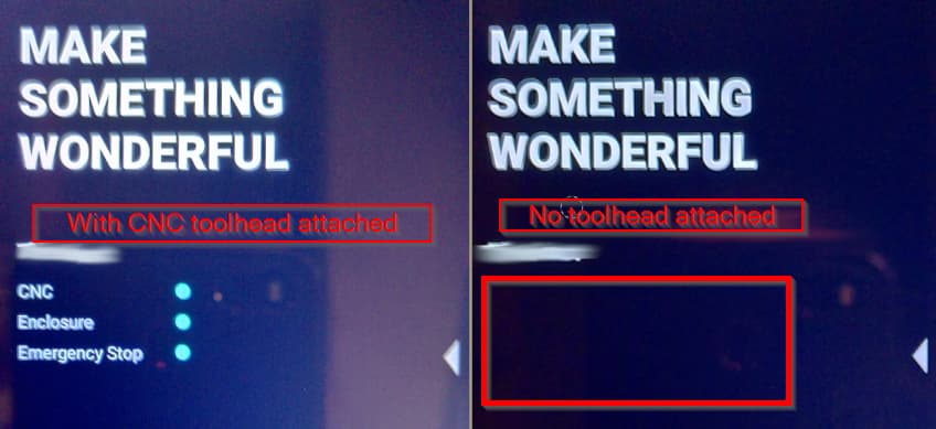

The image you show which lists the three files ending on .json, .db and .lock, I see when no toolhead is connected. In that case, also the Start-Screen does not list any connected devices (usually it lists the toolhead, for laser the camera, and if you have, also the enclosure, stop button etc.). Can you confirm that your Start screen is “empty” in that sense? If so, your problem might be as simple as the toolhead cable broken. Or, worse, the controller might have a broken toolhead port. To check this, plug the toolhead cable into the Addon 3 port (just below the toolhead port). If that changes things back to normal, that’s a strong indication for a broken port. In that case, acquire a new controller via Snapmaker support.

I refer to this image you posted:
Here you expect to see the CNC files, but you see one .json, one .db and one .lock file. This is the same for me when I start my Snapmaker with no toolhead attached. On top of that, with no toolhead attached, the start screen shows an empty space:
If you have the same, my guess is that your toolhead is not recognized. Since all of your toolheads are not recognized, I’d suppose that either the cable or the controller is damaged. Since you tried another port, my bet would be on the toolhead cable. Perhaps you bent a pin when you plugged in the toolhead cable at some point? It should look like this:
grafik
Perhaps one of the six thinner pins is bent? If so, order a new toolhead cable - it’s 8 € or so.
grafik
grafik
