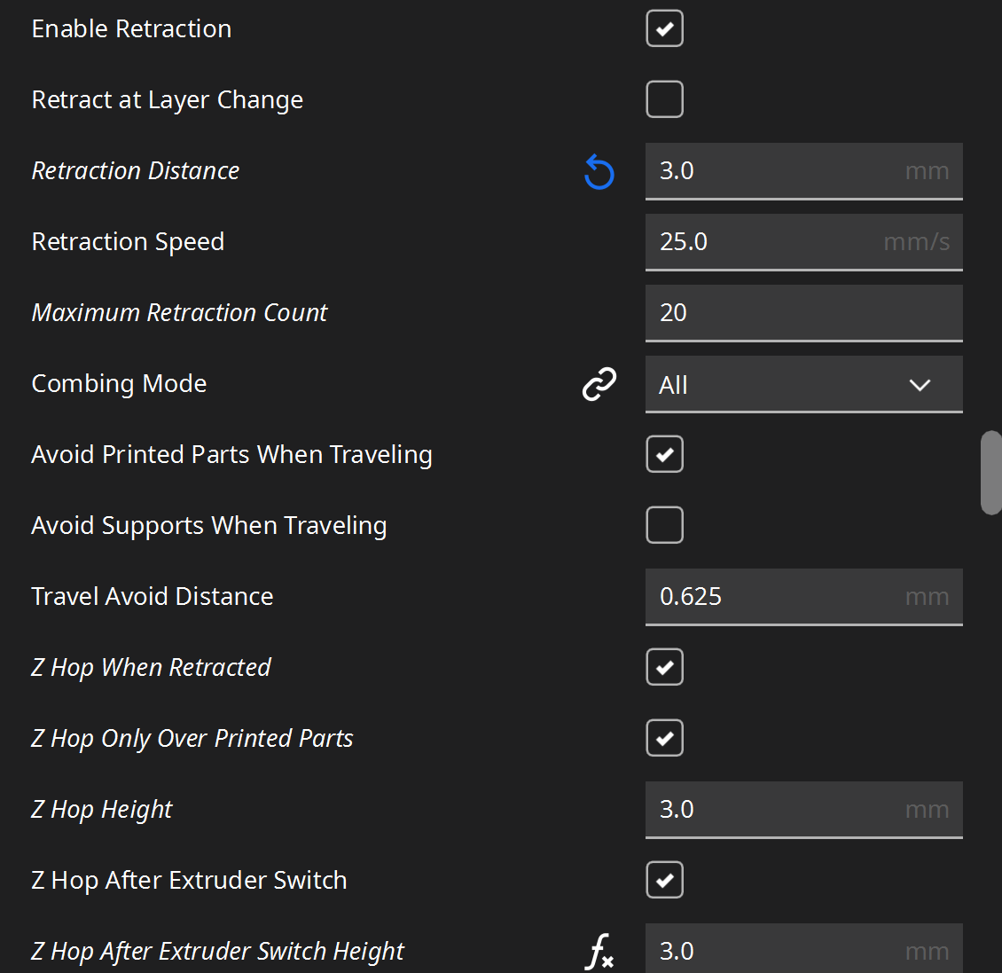

For Cura, I have noticed that there are certain settings that help prevent blobs when switching nozzles. I enabled a few settings such as Z hop and a variety of other related settings. Doing so enabled me to print repeatable, tiny models with a lot of retractions. That is, IF it doesn’t clog.
I also increased the “Nozzle switch retraction distance” to somewhere around 7-10 mm to prevent filament oozing. These are the results I’ve gotten so far. Far from perfect, far from what I’d expect $400 hardware to print. I can say I’m done giving SM money after this release, that’s for sure.
