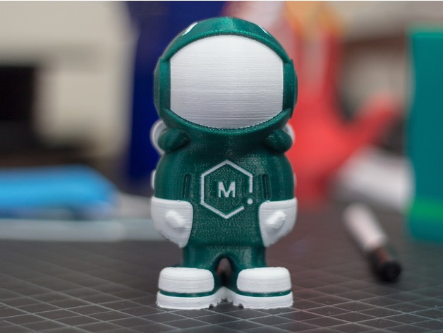

can you share you settings and slicer? your prints look really good.
Luban 4.7 and ‘normal’ with no supports and medium speed and thin structure.
@Mads0100 Really ? Just out of the box with default settings ? I think it would be REALLY helpful to us all if you could spend 5 mins, to expose some of the settings (retraction, temps etc) and materials (even the manufacturer) used. What did you do prior to that for calibration ? Curious, what STLs did you use ? Still need to get my head into DX printing, and merging files…anything there would be super helpful too.
The astronaut and the gimble look fantastic btw - I am stunned by the quality. Nice work
@shudman
Yea, I used to use Cura and Prusaslicer for specific needs but I found the profiles weren’t being updated with the many changes over the last few years and I don’t have the time to nitpick the settings like some of the advanced users around here do.
Retraction is whatever the default in the snapmaker materials… I chose the ‘snapmaker red pla’ for my Polynomics PLa PLus (200/65/1mm retraction @ 35mm/s if I remember correctly, 150c resting temps). The other extruder is set to the snapmaker breakaway PLA support material (220/65/1mm retraction @ 35mm/s if I remember correctly, 150c resting temp). The one change I made with the ‘space man’ was to increase the wipe tower from 12mm cubed to 25mm cubed. I had my tower fall over on the calibration file (the squares) and it also fell over with the minecraft cube. My later prints I’ve done I reduced that to 20mm cubed and it seems to be thicker/holding better. However, I also manually did the z-offset (using the option in the calibration tab on the hand controller) using the calibration card. I couldn’t get the calibration card to ‘bend’ like the single extruder, so I’d put it down to where it felt tight but still moving and then backed it off 0.05mm so it slid easier. After this I didn’t have tower issues.
For calibration, I followed the online prompts during initial calibration. I let it do it’s thing. The only portion I wasn’t happy with was the squares… I’d loaded the break away PLA and the temps weren’t good for it (plus my z-offset wasn’t good and I couldn’t figure it out on the fly). They printed OK minus the tower would fall over. So, I called it good and skipped that step.
STLs were from Thingiverse:
Phil (aka space man)
Minecraft Brick night light:
In Luban 4.7, there is a bottom at the top called ‘align’. I just used that and made sure to assign each model to an extruder using the menu’s at the bottom left of the screen.
For reference; I do have the linear guide mod in my enclosure. That was based on an old guide from here/facebook. I think that helps with the tall objects like Phil.
