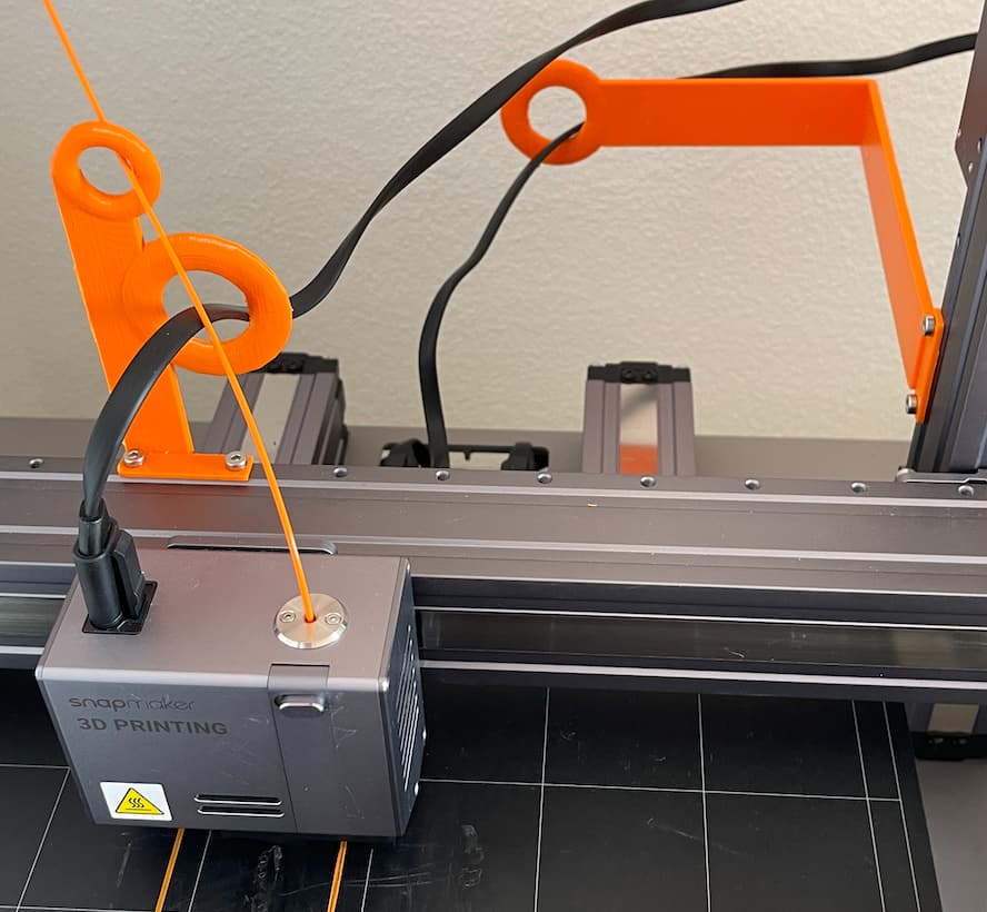

And further, I’ve made two cable guides/ filament guides
Cable Guide Heat Bed
3D design SnapMaker F350 Cable Guide heat bed v2 | Tinkercad
Cable Guide Extruder
3D design Snapmaker F350 Filament and Cable Guide | Tinkercad
