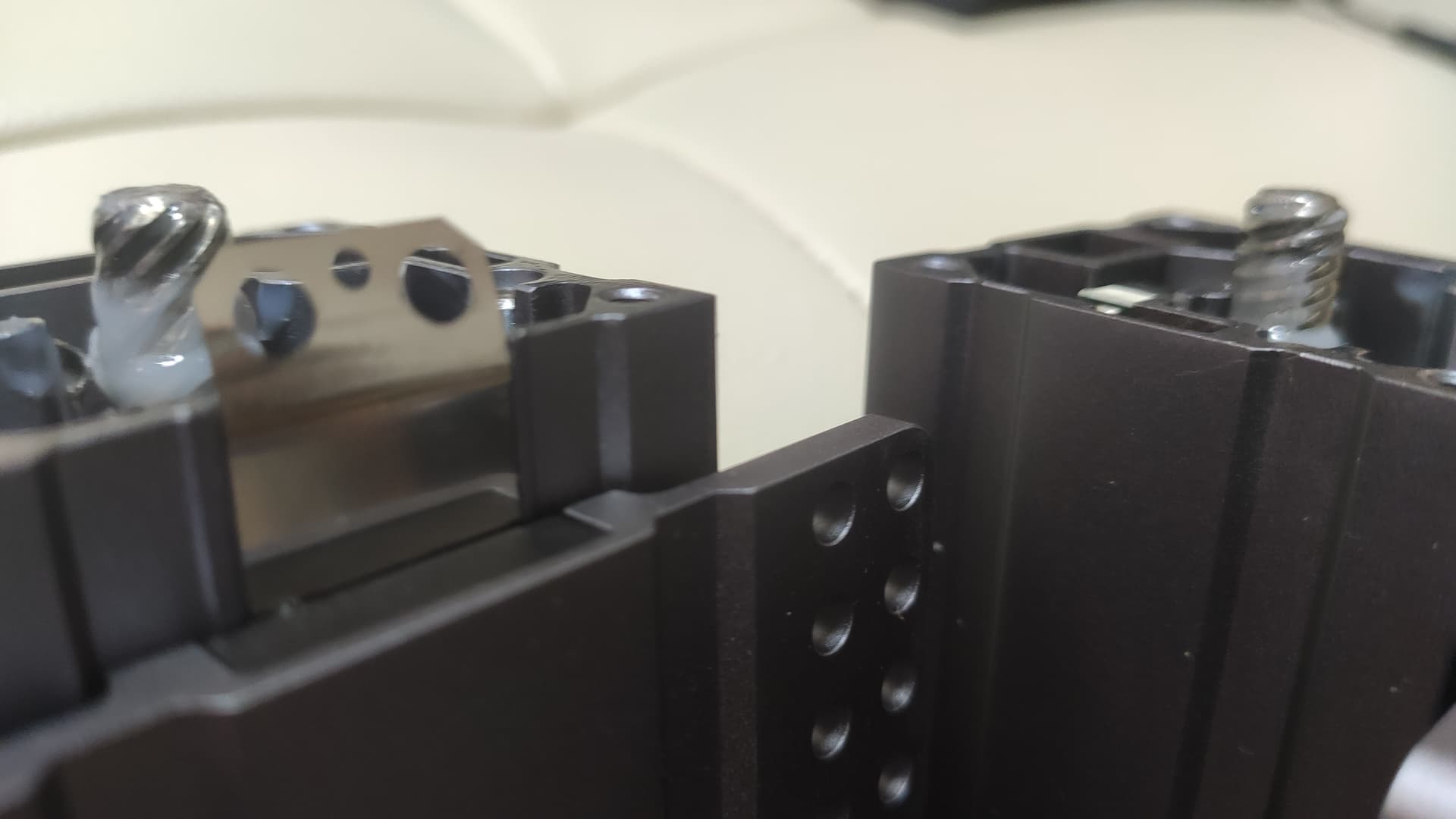

Unfortunately, the structure inside may be the same except for the screw spiral’s twisting angle.
I won’t take it apart any more.

The stepping motor is a different model, but the base has the same number, so the motor and spiral screw may just be different.

The structure is the same except for the diameter of the rotating spindle, which is the same, the screw angle is different, and the motor is different.
I was hoping that the new linear module would also have some rigidity measures to prevent the table from falling or twisting, but unfortunately I could not confirm that.
he table runs away even under the machining load of the CNC.
I was hoping that the new linear modules would have some kind of structural countermeasure to prevent the table from tipping over, but unfortunately I couldn’t see any such countermeasure.

X-axis: 2 x 20mm X
Y axis: 1 x 20mm X
Z-axis: 2 x 8mm X
I was wrong about the previous configuration…
The correct configuration is
X-axis: 1 x 20mm
Y-axis: 2 x 20mm
Z-axis: 2 x 8mm
I experimented with a mixture of 8mm and 20mm, and the controller did not show any indication of the mixture.
X-axis: 1 x 20mm 1 x 8mm
Y-axis: 1 x 20mm
Z-axis: 1 x 20mm 1 x 8mm
When homing, one of the linear rails moves about 10 mm and does not accept operation.
If the 8mm and 20mm axes are installed incorrectly, the left and right axes will be misaligned and the movement will be inclined at an angle, which may lead to breakage at worst.
Snapmaker should display an error message and not accept homing if the axes are mixed.
Also, of course, the speed of 10mm movement between 8mm and 20mm is faster than that of 20mm, and it seems to move almost twice as fast as 8mm.

The code seems to recognize the different versions of the linear module, but when I mix them together, the controller does not issue a “note” or show an error.
I will check to see if I have the latest firmware to be sure.
I checked and the formware was up to date.
The previous configuration was wrong…
The correct configuration is…
X-axis: 1 x 20mm
Y-axis: 2 x 20mm
Z-axis: 2 x 8mm
I tested the above configuration with the following combinations
X-axis: 1 x 20mm
Y-axis: 1 x 20 mm 1 x 8 mm
Immediately after homing with the above combination, only one 20mm axis moves about 10mm, and the homing ends immediately.
After that, the axis moves once in the first operation in jog mode, and then all operations are disabled.
Therefore, there were no warning signs for mixing.
If you don’t notice that the configuration is wrong and you homing with it fully assembled, it will break at worst because the two axes are at an angle.

The previous mixed configuration was all with marked labels.
We added one old unmarked linear module to the Z-axis.
X-axis: 1 x 20 mm marked
Y-axis: 2 x 20 mm marked
Z-axis: 1 x 8 mm marked yes 1x 8 mm unmarked (old type)
This configuration instructed me to update the linear module.
As shown in the picture.
After that, the configuration without 8mm mark was upgraded by the firmware of the linear module.
It will be recognized as “with 8mm mark”.
The old linear module without the mark was said to be useless.
However, it turns out that it can be used as a replacement part for the two Z-axis modules.
