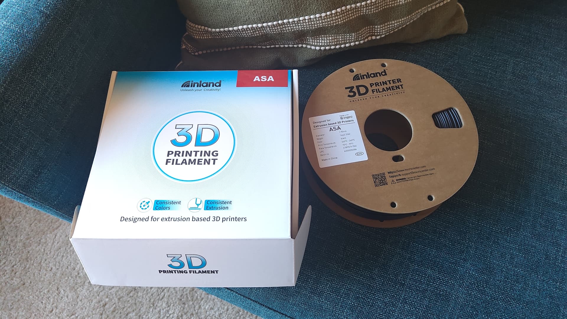

For a test I used Microcenter’s Inland brand black ASA.
