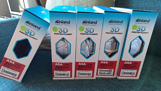

I was excited to try this, as our new local Microcenter has a bonkers array of ASA colors available. Not paid to say it, look at all these swatches just for ASA! It’s awesome!
I went with their Inland Black (boots), White (beard), Vibrant Blue (shirt), Vibrant Pink (hat) and simple Natural colored ASA (skin tone).
Shout out to Freeman from Microcenter who went out of his way climbing through the racks in the back to help me find the Vibrant Blue to make this possible. The color is, well, vibrant!

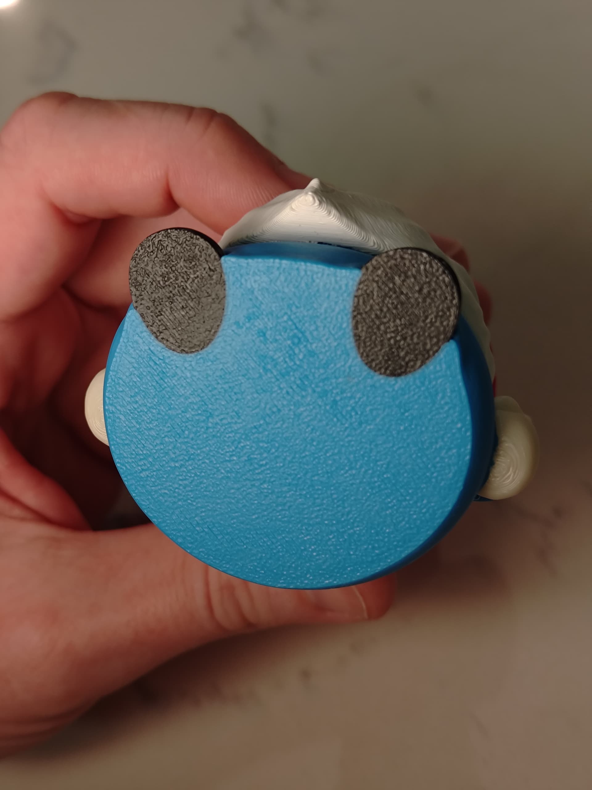

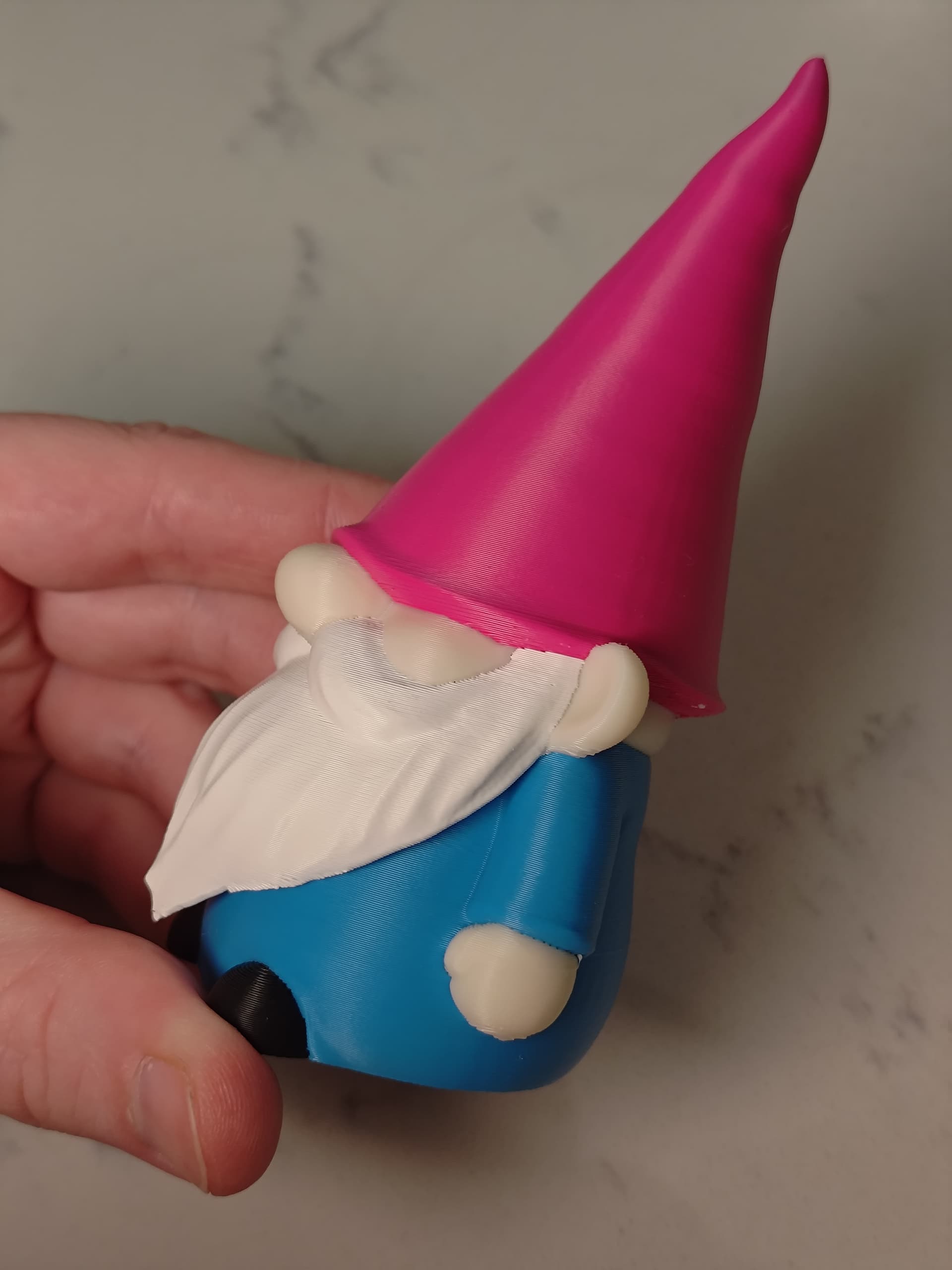

And here he is! I did again use the “cheater stick” (Magigoo) just to guarantee my lil guy finished okay, as I’m honestly still kind of a novice with ASA. It printed practically as easily as doing a PLA print.
He turned out great! The extremely shallow overhangs honestly were a little rough, but my self-created ASA profile had the nozzle running too hot to be honest.
The (supported) free-floating tip of the beard, the precision, the sharp color changes with no color bleed, all very good. He’s ready to look over my balcony!
