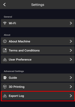

Could export the log files from the touchscreen and sent them to us for further investigation?
Please refer to this image to export the log file and you can find them in the USB stick.
image image

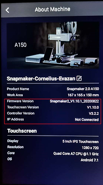

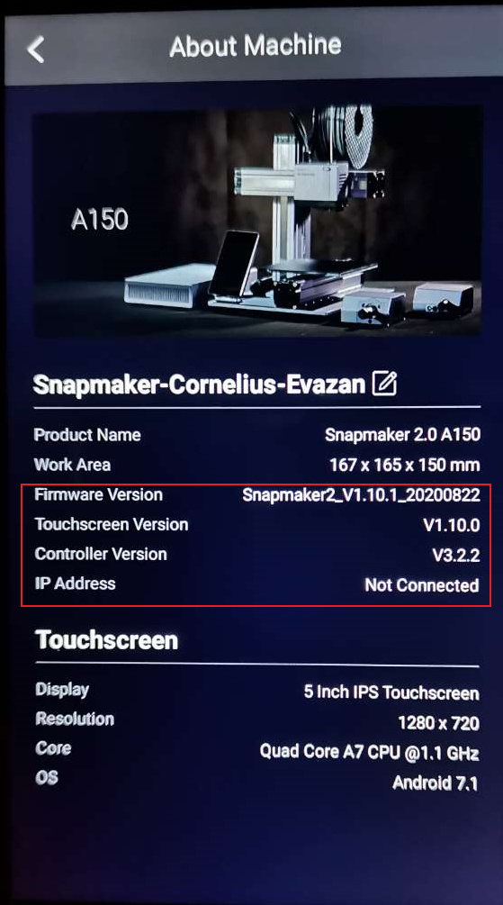

@rojaljelly You might not upgrade the touchscreen version or the firmware version successfully. Please make a screenshot of the “About Machine” page and share it with me.

I’m trying again with a file with a bit more than an hour. Still no Internet, fresh update to 1.10.1 (Touchscreen 1.10.0). Will report later.
Please check if you upgraded successfully?

Showing the same information.
I don’t know if the update worked the first time but ther was no error message.
After going back to 1.09 and again to 1.10.1 I only made 1 print and it was successfull.

The problem may because you did not update the firmware successfully.
Please let me know if the issue remains.
