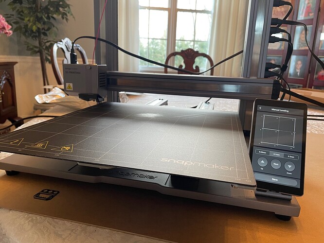

When I run the calibration procedure on my new A350 all of the test points are offset to the left and forward of the center position on the printed grid by about 15-20 mm. When I ran a couple of test prints they were similarly not centered on the bed. I’m pretty sure my bed is assembled according to the directions; it’s centered between the vertical linear tracks at least.
I looked in the settings for a manual adjustment for centering the head but didn’t see any. Is there a way to manually set the center point? When I get around to trying the laser or router I don’t want to be guessing where to place the center of the material.

The calibration (auto or manual) is consistenly off to the left, and the z-axis adjustment at the end does not occur at the ‘center’.
I see no way to adjust this.
The nozzle itself is not the point that is measuring, the sensor is off to the size, so this is why.
Auto calibration was not working, so I am trying manual calibration.
How do you perform the paper height test when the nozzle is not even close to the build platform?
In the photos, you will see the ‘manual calibration’ touch screen, and the position of the nozzle when attempting to measure the first point.
Look at your last photo, and mount your Y modules correct it seems not beeing so.
Check over the hole build!
Agreed, your linear modules are not mounted to the base correctly, they are supposed to fit in that rectangular groove

That was it. Thank you so much!
No problem everytime again.
I effed that up on the initial setup as well. The manual shows an on-end view where the linear modules are clearly in, or not in, the groove. But in practice, the grooves are not visible on-end, which makes it seem like all is okay, as the linear modules aren’t noticeably canted or anything. My own mistake was overshooting a groove in the Y direction.
