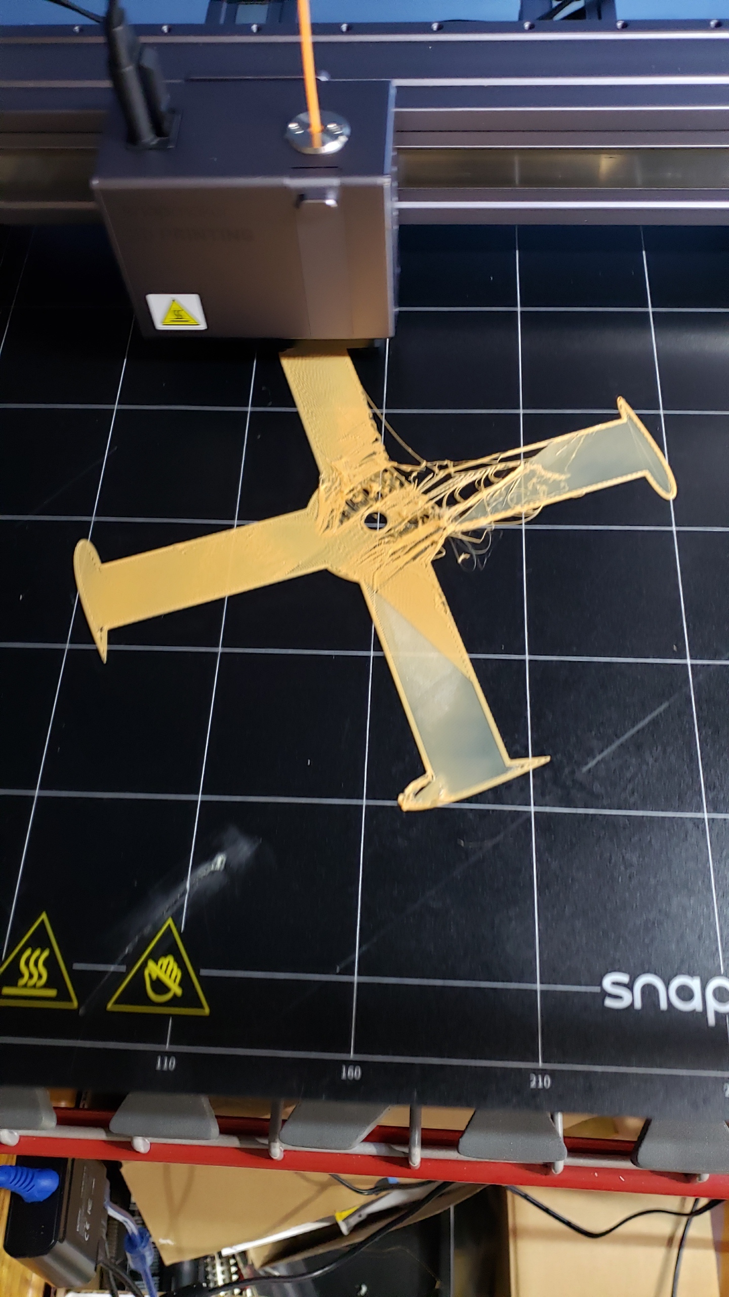

Another odd experience with this issue.
I’ve successfully printed multiple pieces over multiple weeks.
Started on a big complex piece (25 min for Cura to slice, several minute to just download to the SnapMaker, another 5 minutes or so for Snapamaker to parse it)
Started print - and quickly noticed that print was sticking. (different brand of filament) Layers look ok, but didn’t stick.
switched to a small piece to adjust print settings for the new filament.
Switched back to the BIG print.
Auto calibration started pressing into the bed at spot 1.
Power off, power back on, try Full calibration.
Same thing, pushes into bed at spot 1.
Power off, leave it for 30 minutes.
Try again, Full calibration made it to spot 3 or 4 before pushing into the bed.
I’ll try again in the morning.
I’m starting to wonder if there is some kind of over-heating issue with the sensor?
Diving after the print starts sounds more like a Slicer problem.
You could try using Cura to see if that makes a difference.
Mine has never dug in during auto cal. It also has not done the suicide dive when using Prusa Slicer. On this latest attempt I used all factory settings (except filament temp) and sliced in Luban. My issue is my bed is so warped I can’t get a consistent first layer.
