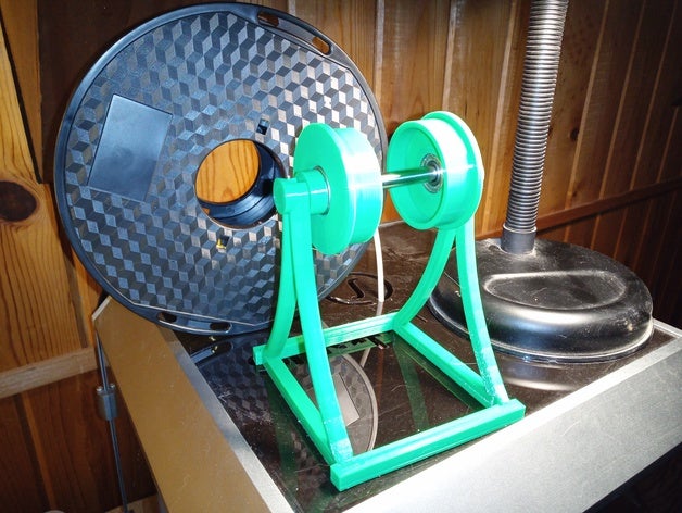

I just got the A350 case, and the standard spool mount for it is TERRIBLE and requires pulling the filament through a hole at right angles to source and destination.
I’ll setup an alternate spool mount and see if that helps.
I agree about the questionable spool mount… someone posted an .stl model in the Facebook group, but I haven’t gotten around to printing it yet and I don’t know if it would reduce the tension in the filament.
This is my setup, it’s like my setup at the original:
I’ll be doing something similar. (though with more testing, I’ve found that isn’t causing the problem with feed stopping. Problem was solved by replacing the Hotend.)
I’ll probably make a minor mod to the spool mount I already made for my SM1, and drill a small 1/4" hole in the middle of the top, right over the printhead.
Just need this a bit wider to allow the user of a auto-rewind setup.
