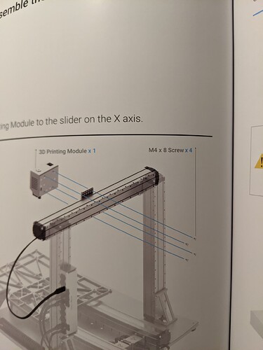

Installed the 10W laser yesterday and couldn’t work out why it kept stopping complaining about overheating. Looked today and sure enough I had used the M4x10 screws used by the other heads. Installed the M4x8 that came with the 10W laser and no overheating problems. Problem is the fan is a bit rooted now and has a really high pitch squeal coming from it.
There is absolutely no warning on the head or the manual that you must use the screws that come with the head.
This is pity piss weak not warning us.
People always blame others for their inability to follow directions… In the original snapmaker assembly manual, it says to use M4x8 on the toolhead, and again in the 10W manual. Why do so many people use the M4x10?
From my old A350 manual:
M4x10 use is user assembly error.
Thought all the heads were installed with M4x8? I just reused the screws on my 3D print head.
