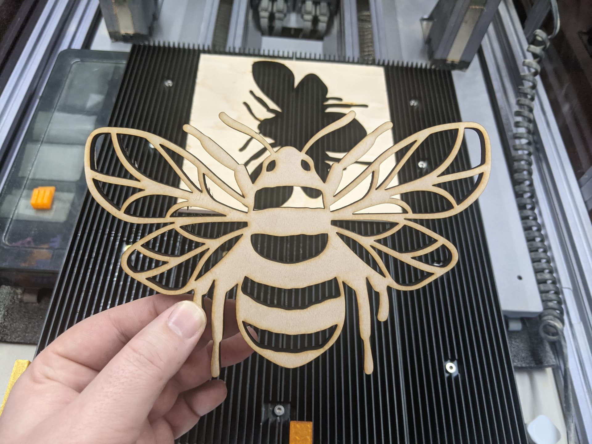

I haven’t had the module long (a few hours, not long enough to formulate a real review or anything) but there’s a few things that stick out to be annoying, but at the same time, it lives up to the ‘massive power upgrade’ claim.

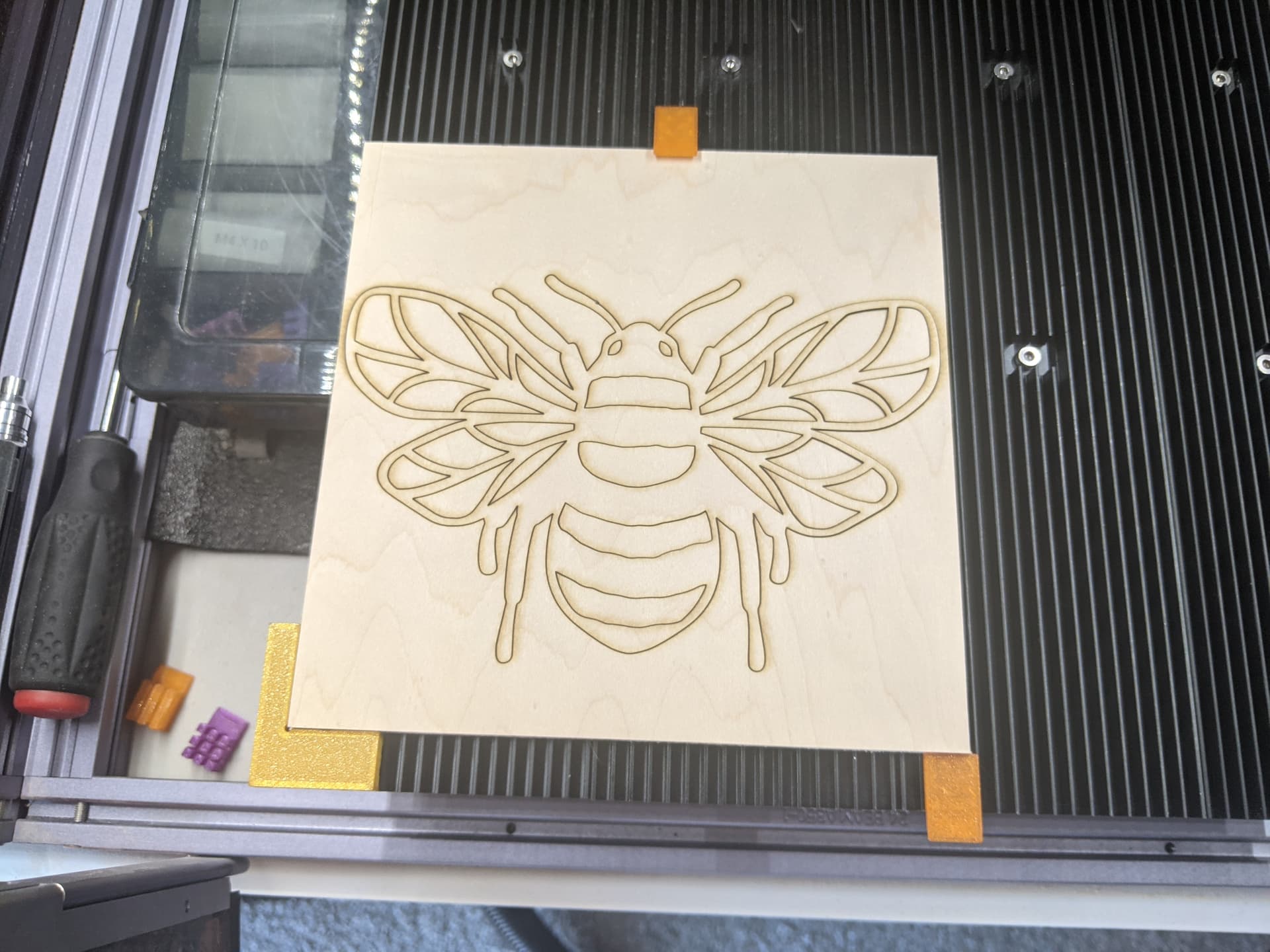

First off; the very first test.
Material; 5mm Maple plywood, poplar core.
Using the default 5mm settings in Luban 4, one pass, took 14 minutes. I’ll note to put lifters under it to keep sticky smoke residue off my plate in the future, but impressive results. So the power upgrade is definitely there.
Next came setting up for the new true origin… this is where things go a little mank. Apparently Luban has a problem with origin mode. The bee was done with the image capture, worked great. However, trying origin mode it seemed a bit random as to where it actually started. Even manually adding in G53 and loading it back into Luban, it was… way off. Something like ~30mm difference from sending the file to the snapmaker and running it locally. Maybe a restart would have helped? I don’t know. Moving on.

I like the look of that, one pass 5mm cut??
Not entirely understanding your origin descriptions…guess I’ll find out soon, mine supposedly delivers today, hope to do a test lasering by Weds.
Also like your corner-crowd and edge clamps…off to Thingiverse to see if I can find them! I’ve done very little lasering and so far been using ‘museum putty’ globs as my ‘clamps’.
PrusaPrinters ;p these are my custom corners. Look up laser bed clips for the small ‘clamps’.

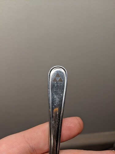

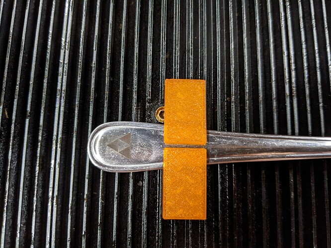

Finally did a test of stainless steel, now I have a custom triforce spoon. :stuck_out_tongue:
Settings were Line mode engrave, 0.12 interval, 100mm/min workspeed, and 100% power. No type of coating, bare SS.

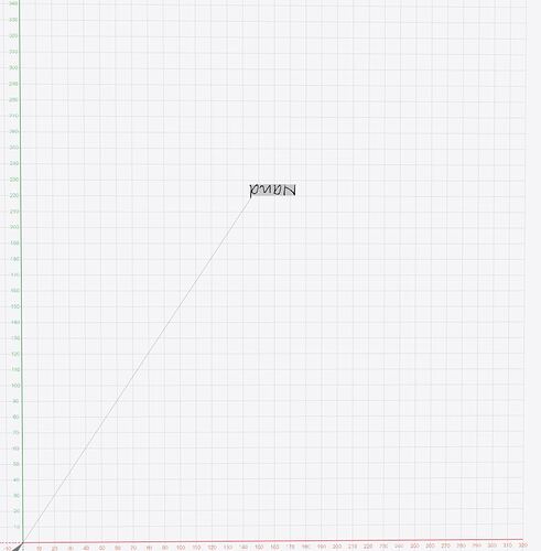

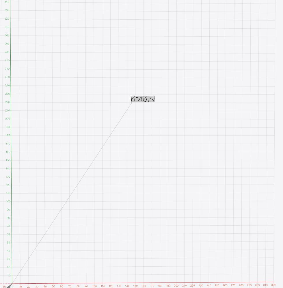

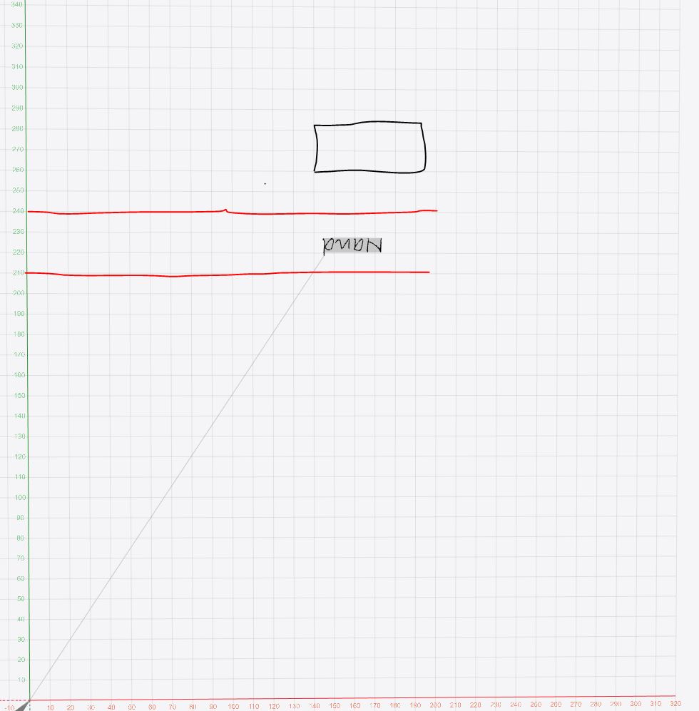

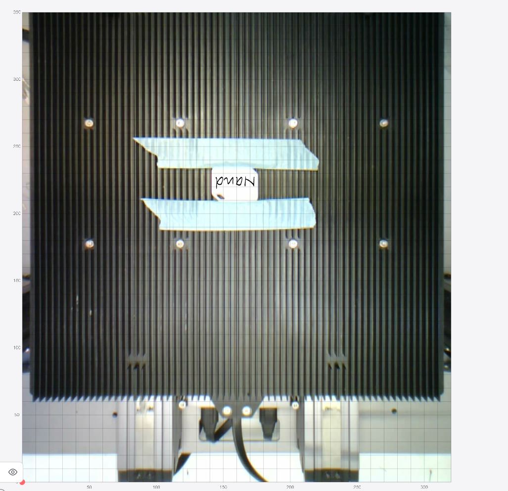

I am having a strange problem also. Calibrated the laser fine. then used the supplied keychain and attached it at the center of the bed. tried to engrave my name on it. But when i have the text middle on the keychain. it shows it in the workspace at the exact same spot ( between 210 and 240 ) but starts the engraving about 5 centimeters higher than the keychain is? what is going wrong here?
Ah found it. The blue square in the calibration of the photo took the edges of the bed as edge of the calibration corner. Manually adjusted the square to the 4 point and now it is good.

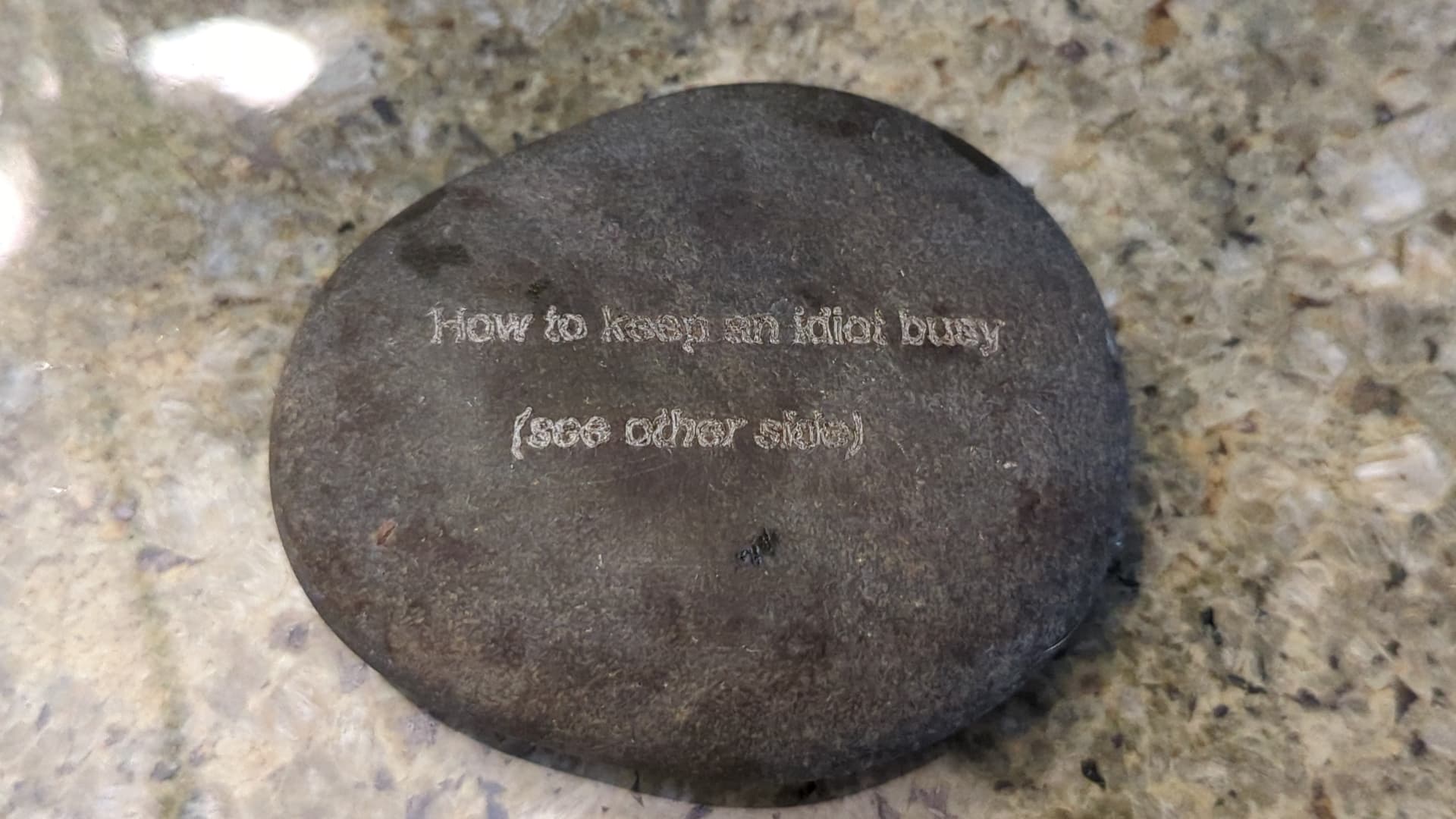

Stone works just fine:
300mm/s, 100%:
300mm/s 80%:
Looks like I could still go considerably faster/lower power, but each of these runs took ~30s

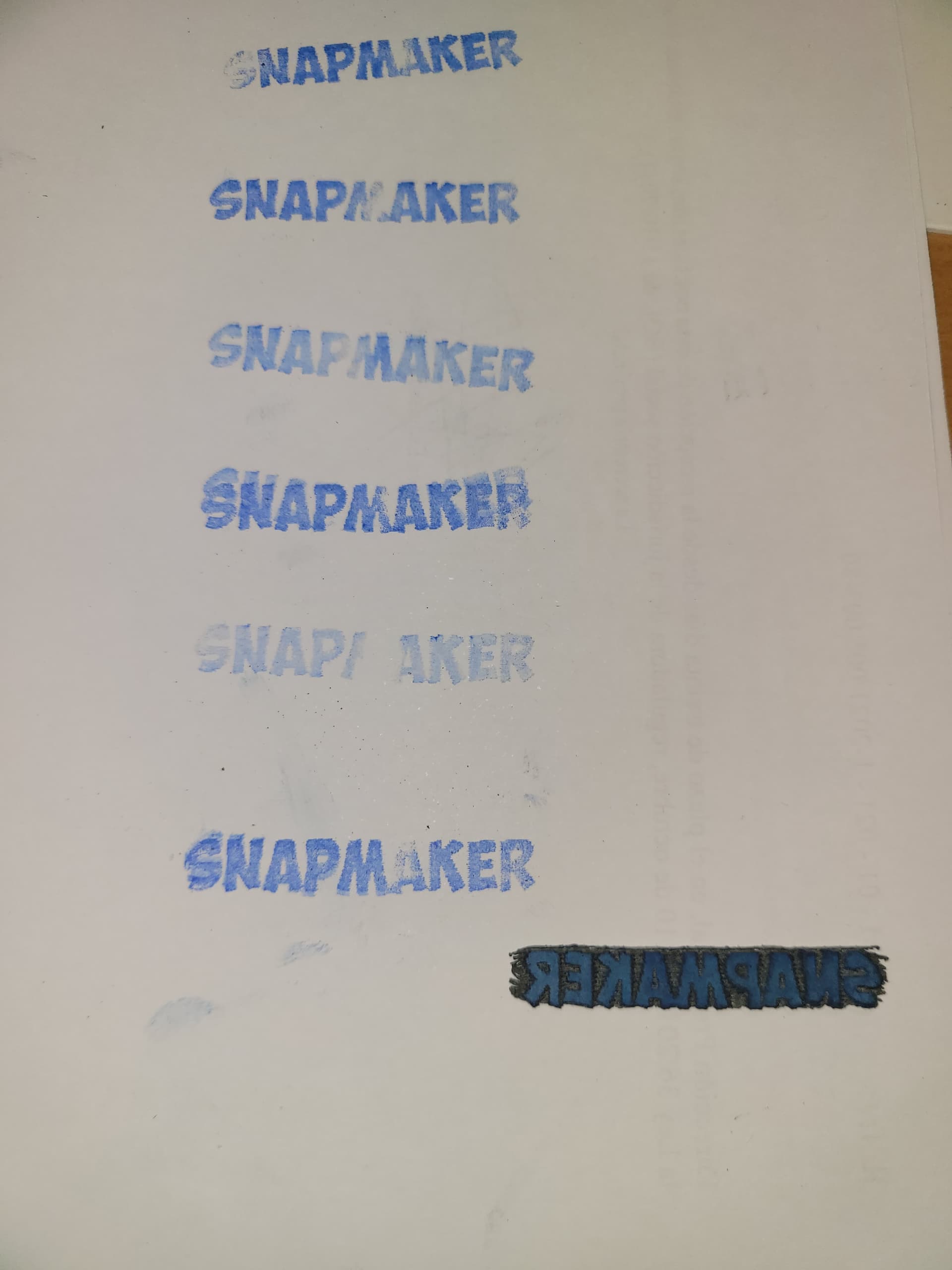

I have already received the 10 w laser. I am doing tests with a 2.3mm rubber sheet (it gives off a very bad smell…). I’m trying to make a rubber stamp with a word. Any idea how to configure luba so that it cuts the parts where the letters are not? With the vector option, I cut the outline of the letters, but not the entire other area. And with the other B/W, grayscale and halftone options, it doesn’t quite cut it right either. A vector option would be needed but would cut off the inverted part of the word or picture. Any ideas ?
Well, I’ve been doing tests all afternoon and finally something positive comes out and it’s pretty quick to do. I’ll keep trying, but at least I’m clear that you can make rubber stamps with rubber sheets.
