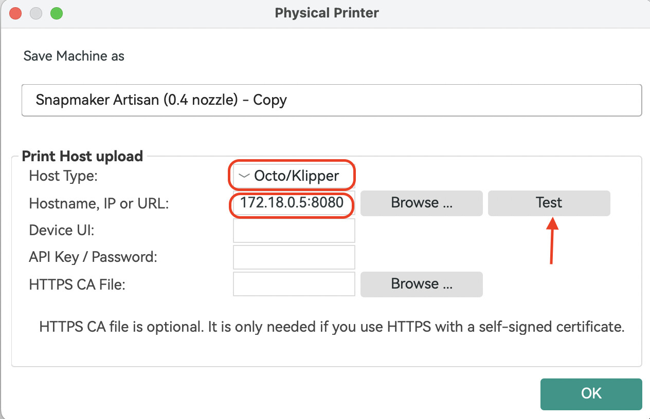

  1. Added Direct Machine Connection support for Snapmaker Orca. You can now send G-code to your machine over Wi-Fi without using Luban as a transfer station. Snapmaker Orca communicates directly with your machine through the OctoPrint protocol.

Steps for Direct Machine Connection in Snapmaker Orca
  1. Click to enter Connection.
  2. Select Octo/Kilpper as Host Type.
  3. Enter current device IP:8080 as IP.
  4. Click Test to enable the connection.
  5. Click Print > Upload and Print in the pop-up window.
With this beta version you no longer need to open Snapmaker Luban first to establish the connection. The only difference from before is the IP-address format, which now becomes: current device IP:8080 , e.g., 192.168.0.1:8080 .
