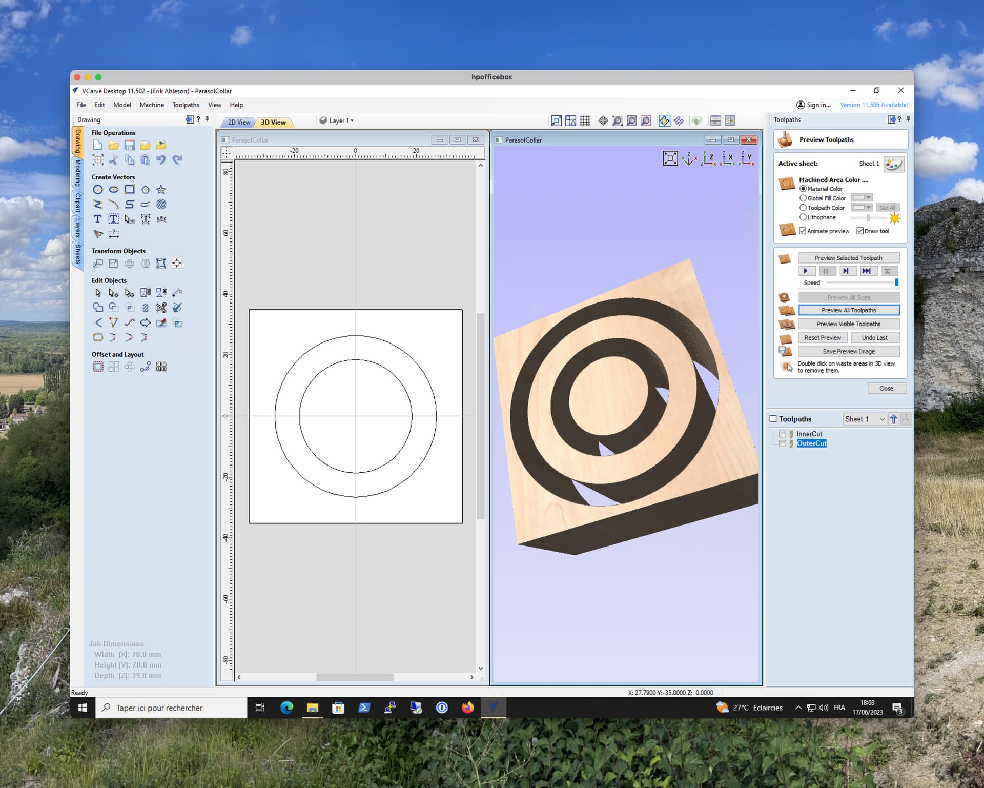

I’ve used the vCarve post-processor successfully in the past for both standard cuts as well as 3D stuff. But I haven’t use the CNC module in a while and I just created a very simple set of circular cuts in vCarve 11.5 to make a collar for a post and when I run this on the Snapmaker A350 it simply moves off-center and starts drilling down.
Here’s what the design looks like in vCarve.
And here’s the .cnc output passed through the latest official vCarve post-processor from https://github.com/Snapmaker/snapmaker_cnc_post_process

Use the Aspire Post processor. It’s identical to the VCarve processor but it doesn’t use absolute coordinates for arcs which is what is causing the problem. I am having another problem where it runs super slow during small circular cuts (almost to the point of stopping). It still finishes cutting but takes 5x longer than it should. Trying to track that issue down right now. I’m sure it’s another issue with the post processor so should be an easy fix.
