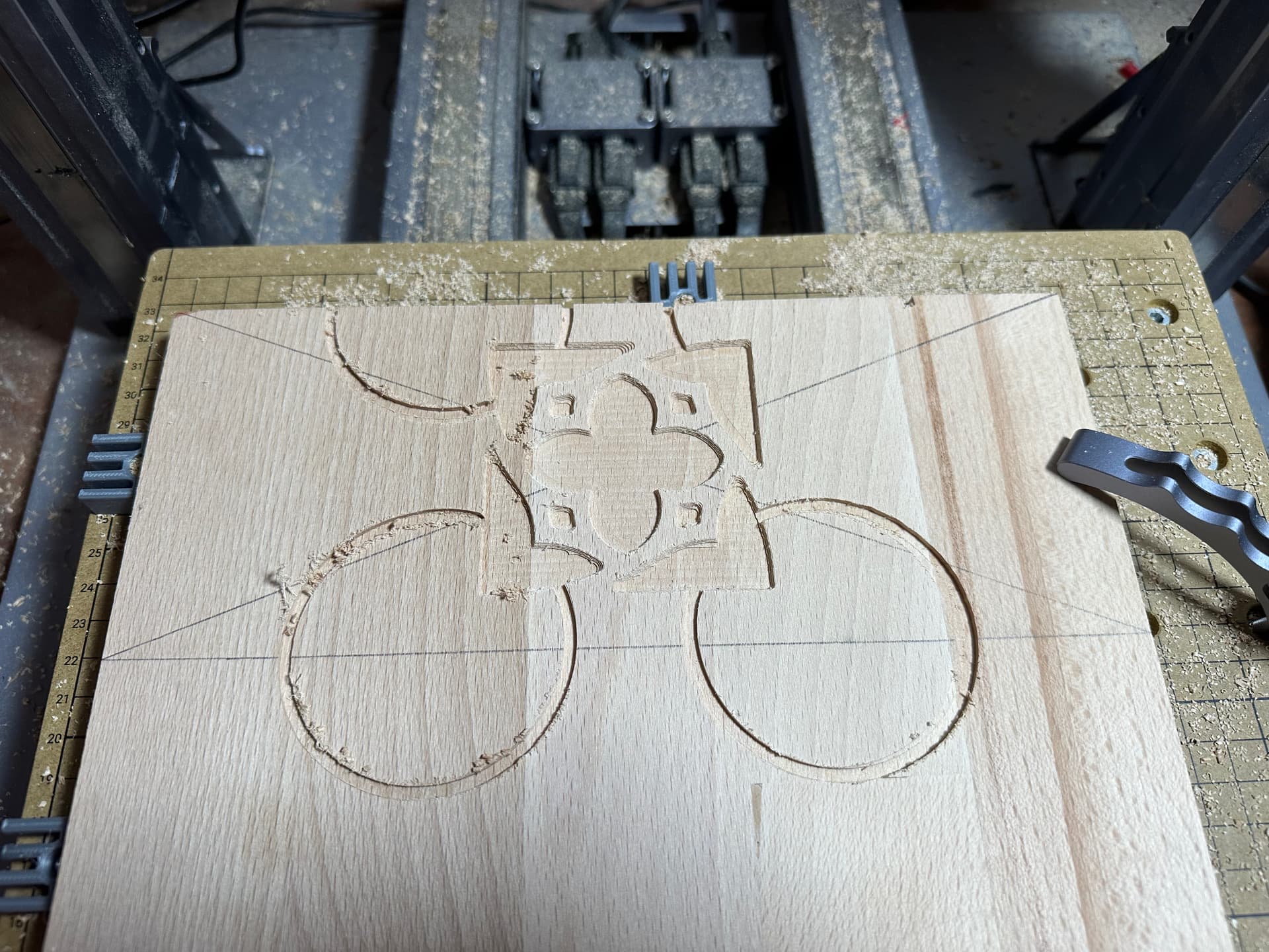

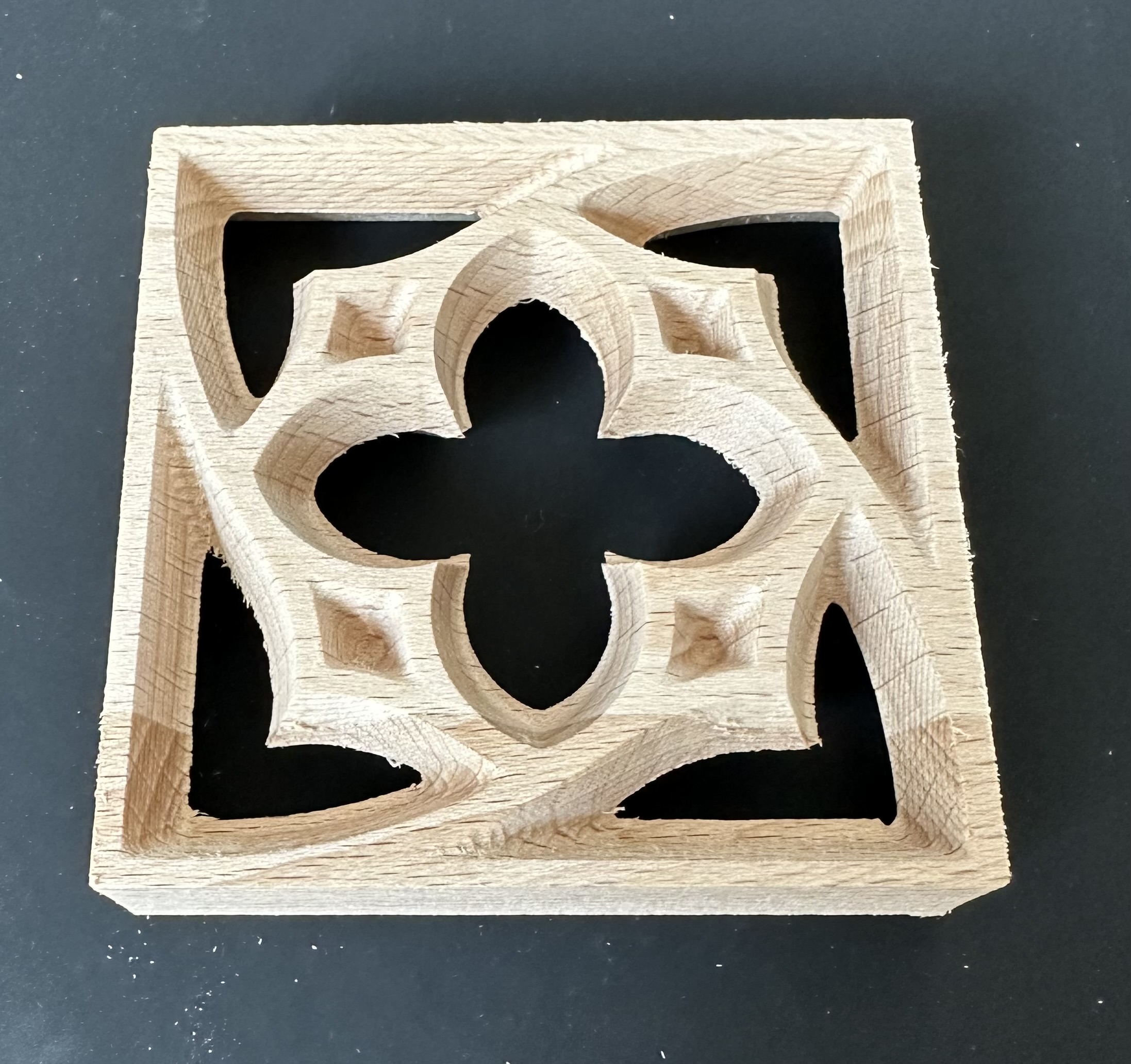

OK - here’s a strange one. I’m cross-posting between the Vectric and Snapmaker forums to see if anyone can shed some light on this problem. Here’s a pic of the end goal.
So I’ve created a roughing path with a 3mm end mill, but every 4 layers or so, it decides to route a ~6cm circle centered on a point about 1cm diagonally outside the corner of the work boundary. It seems to happen about every 4 layers and the first one was on the bottom left corner.
The last one went out of bounds of the wood (first time circle) and slammed into the side about 2mm down so the end mill couldn’t cut the line like it had one previous circles.

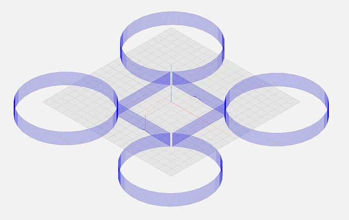

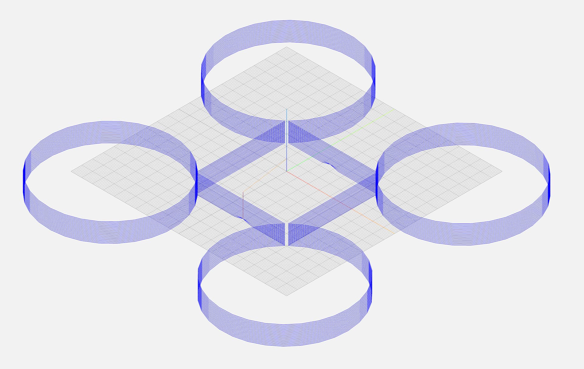

It’s the latest firmware and after some more feedback, it seems to be a bug in the Marlin library used in Snapmaker. Someone pointed me to https://ncviewer.com where it previews Marlin gcode which displayed exactly what the Snapmaker tried to cut, even though the gcode doesn’t include those arcs.
A support ticket has been opened.

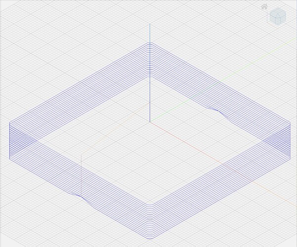

And the result of the ticket is that the Marlin code they’re using doesn’t properly support G2 & G3 commands. But the workaround is to preview any models using https://ncviewer.com since it appears to use the same library and will show the badly interpreted G2/G3 arc cuts. For roughing passes, you can generally just delete the G2 lines and the arcs will get routed out by the subsequent actions so it’s not a big problem.

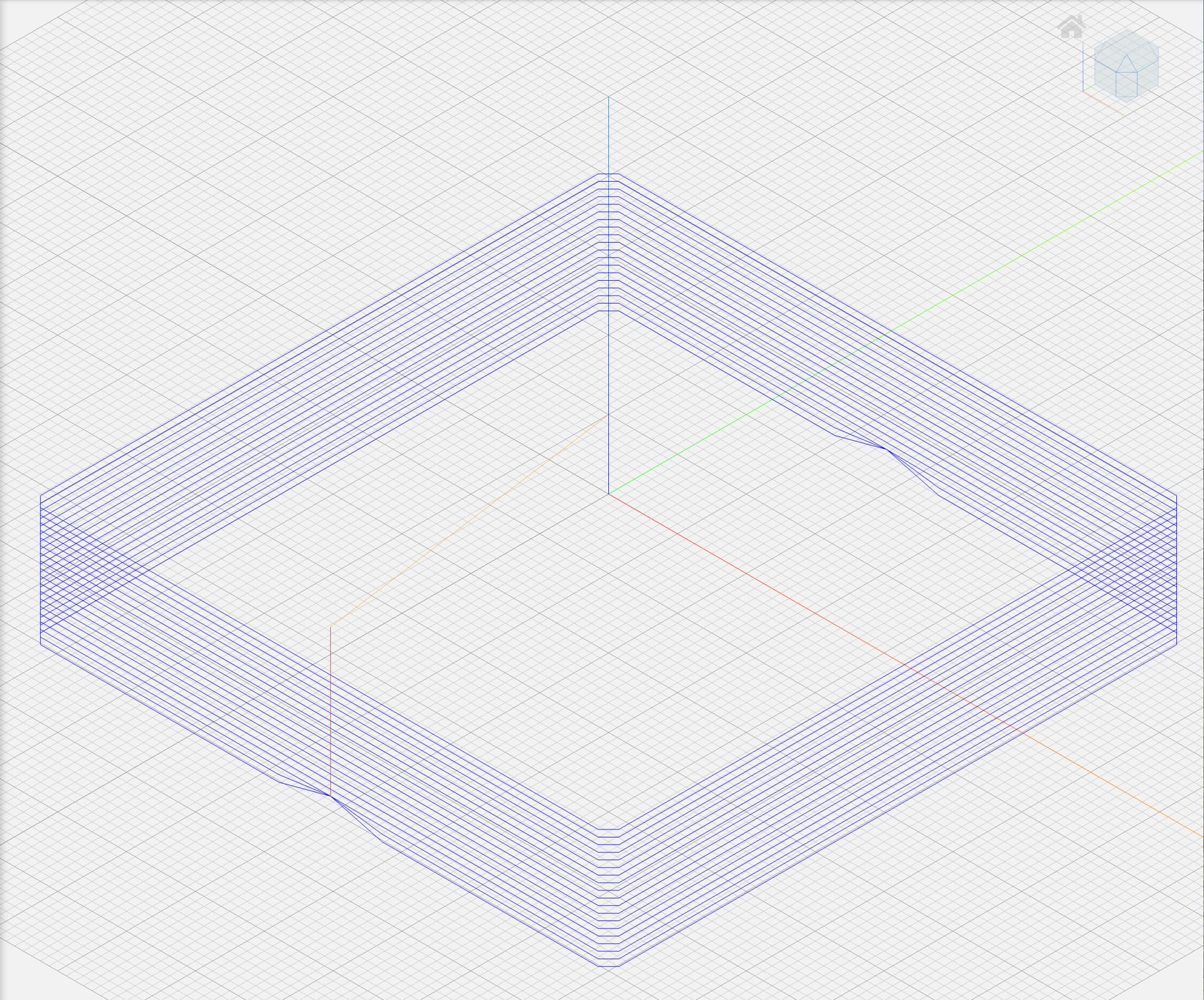

I tried another simple job to cut through a board with tabs and this one generated G3 arc commands that generated the circles in ncviewer so I tried replacing the G3 commands with G1. The result is that it was no longer an arc cut in the corners, but converted them to straight lines, which was OK for a simple cut routine.
G3 Arcs:
G3 commands replaced with G1 (simple search and replace)
Upshot: always preflight your jobs with ncviewer and either remove or replace the G2/G3 commands.
