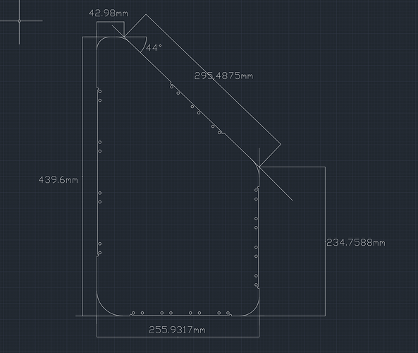

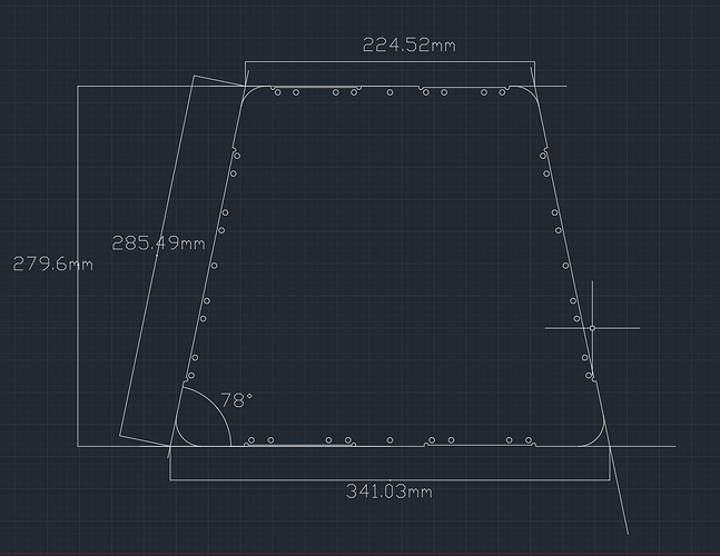

great work. Is there a recomended Thickness/strength for the PC?
PC sheet thickness 3 mm

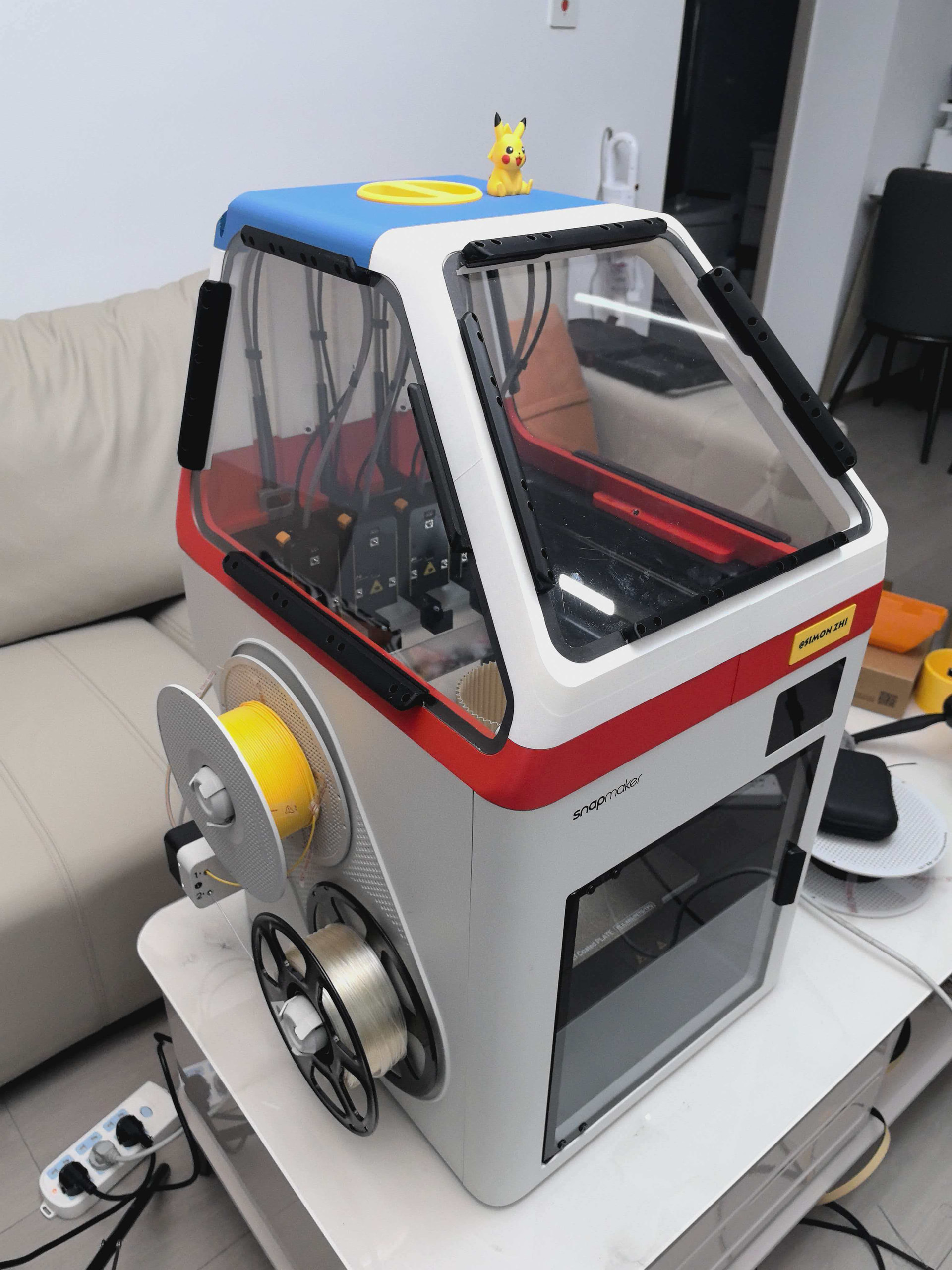

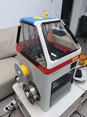

I have just completed this specific mod, using the IKEA 45L (12 Gallon US) plastic bin. That cost me $8 at IKEA. I printed the OPEN frame version, which does NOT require you to remove ANYTHING. It just slips over the top, with cutouts for the PTFE/USB.
I must say this is a brilliant design! Total cost around $10 and it works! Even using it only for dust/debris protection for my U1 is well worth it, but it does hold in at least some of the heat too.

Assembly tutorial diagram:
Done!!!!

The file can also be used for laser-cutting acrylic.:grin:
Is there a version where the PC-plates have non-rounded-corners? Would be much easier to cut myselve…

Hello, im trying to upload the dwg file to an online store to have the PC sheets cut however its telling me that the contents are not closed. Also, is that one file all thats needed for these panels to be cut? Im unfamiliar with dwg files so im not sure if the angles of the curves and measurements are all included in that one file.
Enjoy it!
I just realized I uploaded a DWG last time—DXF is more universal, so I’ve updated the DXF file. If you’re using acrylic, you can send it straight to a laser cutter; if you’re using PC sheet, it’s ready for CNC engraving.
