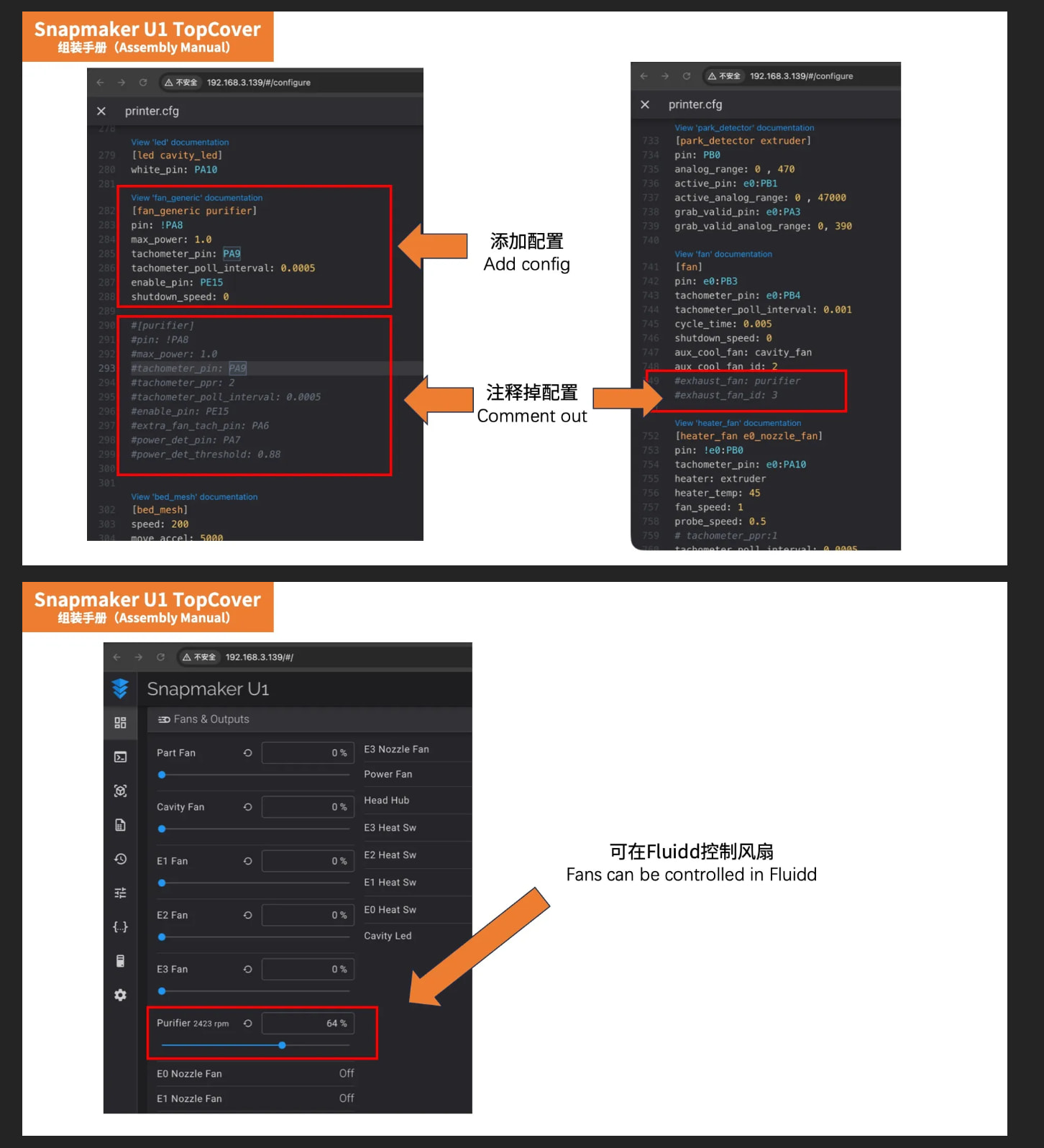

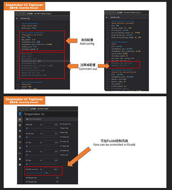

Both flag and flag2 are tied to GND, and attempts to enable the 24V power output have failed. Firmware version is 1.1.1.122. I don’t understand the design principle of this circuit—have you successfully obtained power?
This should control the top-cover filter fan; you probably need to enable air filtration in the slicer to coordinate with it.
I would like to use the port for connecting an LED to better illuminate the build area. However, I am not getting any voltage at the connection. It didn’t work with Orca using the exhaust fan. Unfortunately, the G-code M106 P3 also doesn’t work.
How can I activate the 24 volts on the AUX connection?
