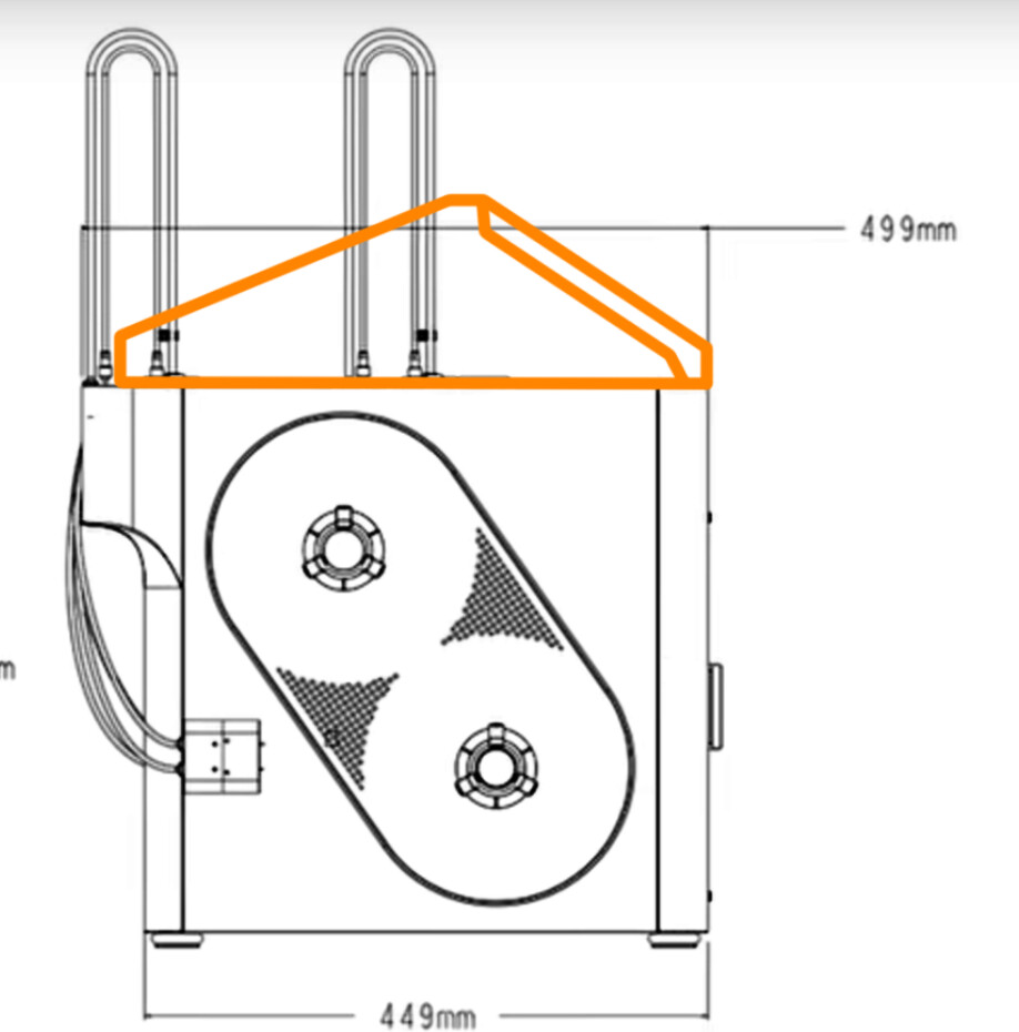

4.The official dome is pretty tall; any tricks to cut down on material?
  • I’ve sketched a Cybertruck-style double-slope roof, but the tricky part is routing the cable chain outside while keeping the print head and PTFE tube free, yet still holding enough heat in the enclosure. Like this:

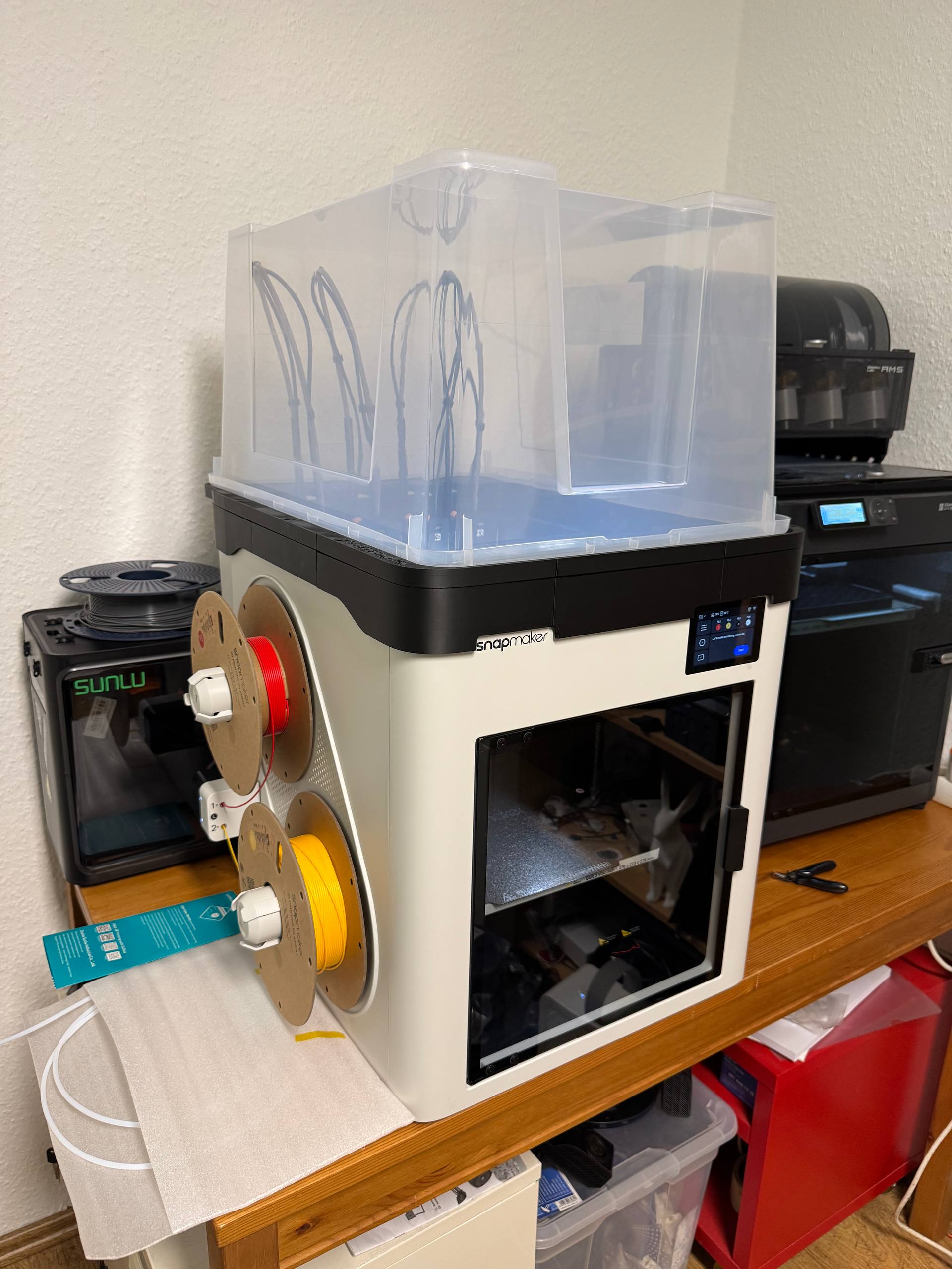

Don’t you want to try the IKEA hack?
  1. https://makerworld.com/models/2031310
photo_5274230156459445075_w
Its COOL!!I can offer everyone one more option!

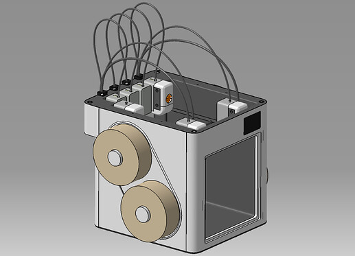

  • Surveying enclosure
  • If you want to design the top cover yourself, here’s the 3D model of the U1 enclosure and key structures I reverse-engineered, packed as an STP file.
    (PS: dimensions are not 100 % guaranteed, but I matched the real specs as closely as possible.)

  • The structure I originally envisioned would require too many extra parts. Although I came up with a fairly feasible idea—using thin PC sheet, rolled up for storage and then unrolled— it still involves manual cutting and buying additional components, so I’d rather keep looking for a simpler, cleaner solution that others can easily replicate.
  • I have reorganized my plan, analyzed the trajectory of the Teflon tube, and designed a frame that is as small as possible.
