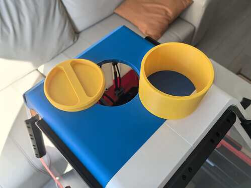

Here is the final version appearance effect that has been tested so far.
PS:I will update later when I have time: LED light installation (mounting points already reserved), small-size panel drawings, and a recommended installation tutorial.
Nice work looks really good. The little dragon peaking over the back was a nice touch.
Wait, did you use PLA to print the main body? How will it handle heat?
Yes, I printed the main body directly with PLA, and the panels are PC sheets. As long as the chamber temperature stays below 50°C, I think it’s fine—most of the time I don’t print materials that need special insulation. So regular PLA/PETG/TPU is already enough. I’ll add a small thermometer to monitor it later.
  1. The side and front doors are magnetically attached and can be opened directly. I’ve also reserved a vent on top that can be opened manually or later modified with a fan and filter.
  2. Since my machine’s back is close to the wall, I didn’t consider adding filtration or fans there, as it would protrude too much. However, the back piece is 3D-printed, so mounting holes can be updated anytime—let’s discuss if it’s needed.
  3. The side doors have an angled design; fans and filters can actually be mounted on the PC panels by simply adding four mounting holes in the CAD for DIY modification.
