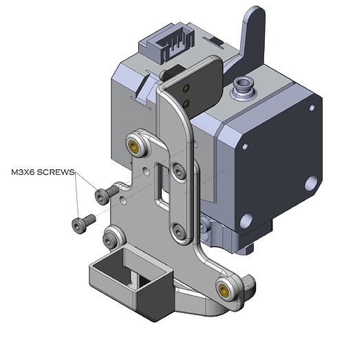

  8. Assemble the fan mounting plate and the Bondtech extruder using (2) M3x6 screws.

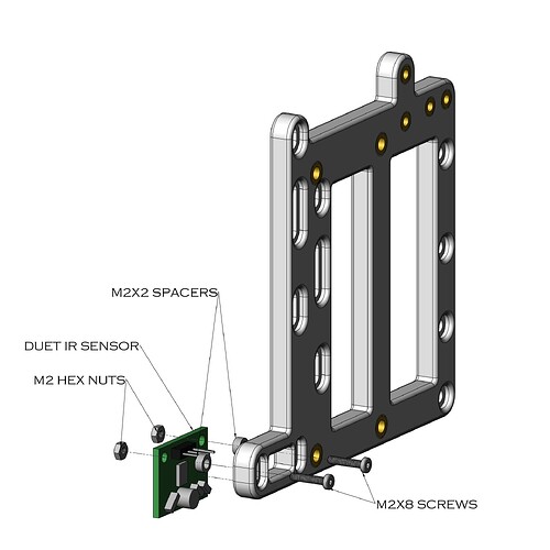

  9. Attach the Duet IR sensor to the adapter plate using (2) M2x8 screws, (2) M2 hex nuts, and (2) M2x2 spacers. Remember to put the spacers in between the adapter plate and the IR sensor. Make sure the IR sensor is 8mm below the bottom of the adapter plate.
  10. Combine the Bondtech extruder and the adapter plate using (2) M3x8 screws. Make sure the nozzle is 9mm below the bottom of the adapter plate. Use the correct holes for the hotend you chose based on the photo below.

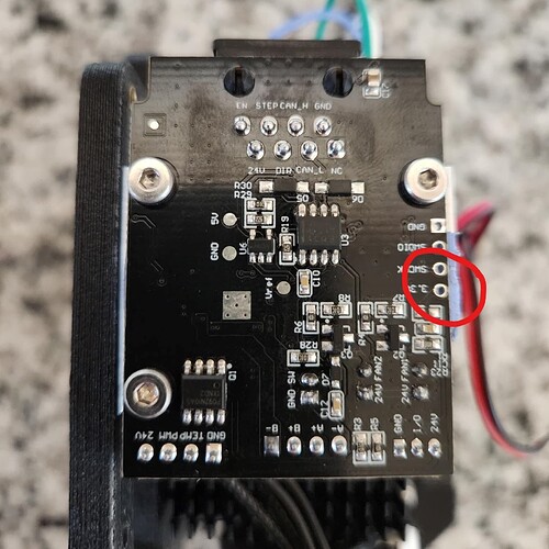

    c. Next is the most challenging cable because you’ll need solder a wire to the 3.3V port of the Snapmaker’s 3D print board. Make sure it’s coming out the back side and does not interfere with the aluminum mounting bracket on the front. Follow stewl’s guide from earlier to make the wire (with the resistors and transistor), and use the 3 pin Dupont connector on the side for the for the IR sensor, and the 3 pin JST-PHR connector for the 3D print board side. I don’t have this shown on any working 3D print boards because I have plans to make an adapter PCB board so no soldering is involved.

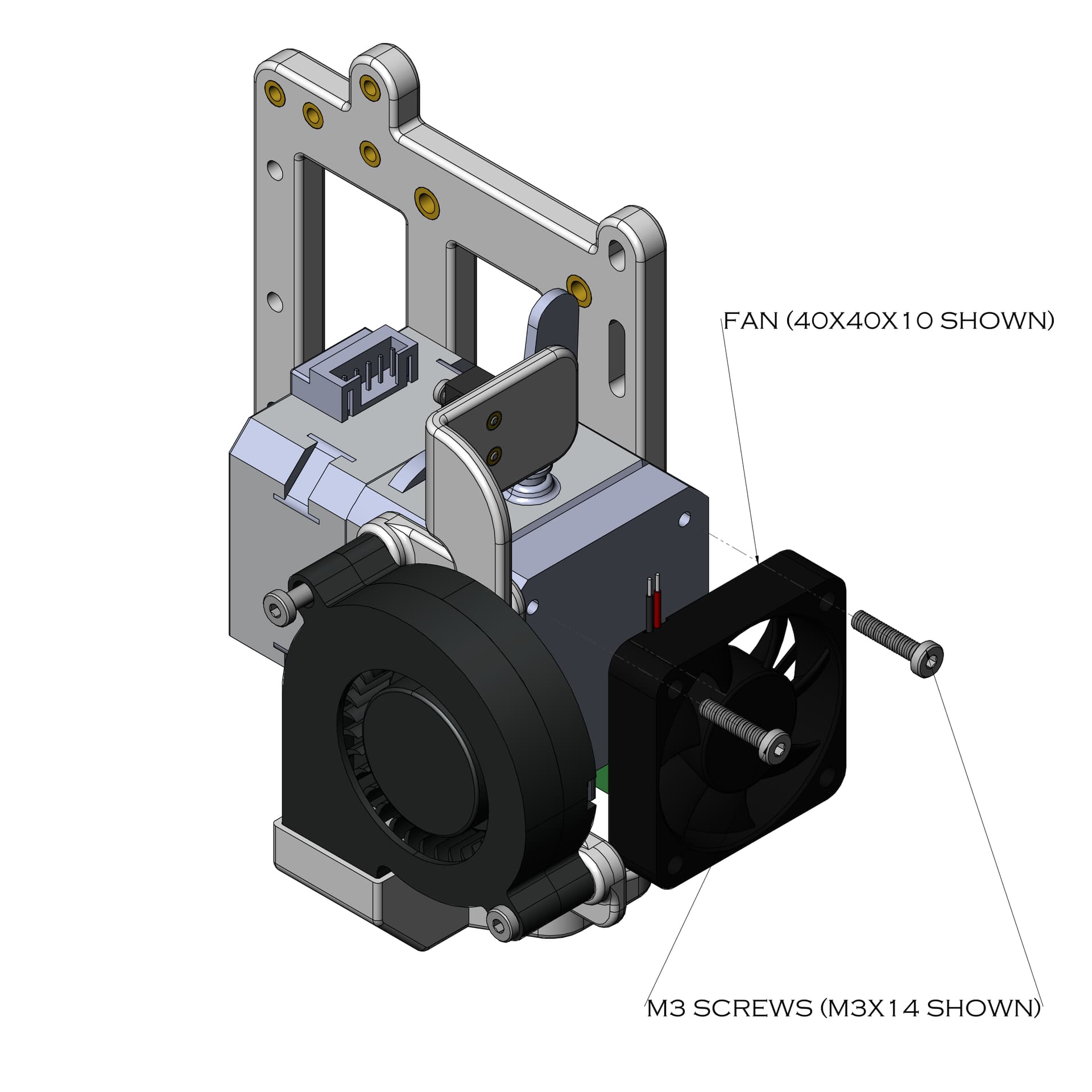

  13. Add the hotend cooling fan to the assembly. Use the provided screws if using the Slice fan, use (2) M3x25 screws for the 40mm x 20mm fan, or M3x14 screws for the 40mm x 10mm fan.
  14. Attach the 3D print board to the adapter plate using (2) M3x6 screws.
  15. Carefully wire all the components to the 3D print board. Reference the diagram in step 11 to make sure you have the wires in the correct spot. Put the 2 fans and the IR sensor through the zip tie, but do not tighten it yet.
