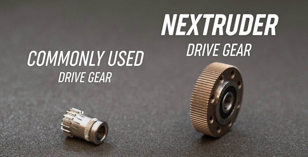

I think biggest roadblock is the diameter of the direct drive gear. It is too small to push the filament and not cut chunks out of it. It is way bigger at the dual extruder (hense the 22mm³/s max flow). But compare the dual extruder gear with with Prusa MK4…
Then goes the heat block, it needs more thermal mass to keep up with the CHT nozzle. Not sure if improving on thermal interface makes sense here (aka lube the threads with paste).
For ultimate fast extrude solution - The (mostly) Complete Guide to Bondtech, Slice, and the Snapmaker 2.0
