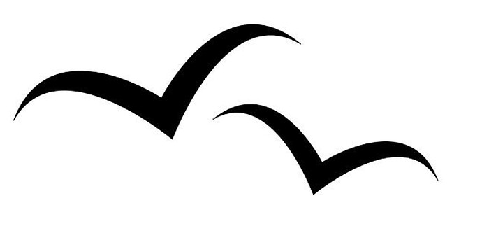

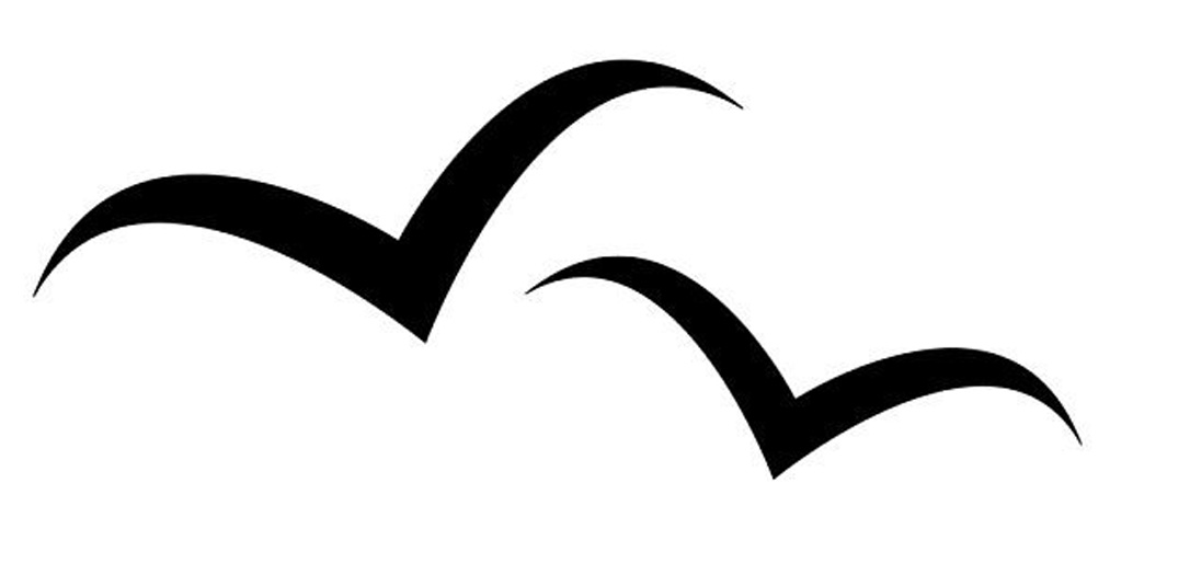

I will try to add the pictures to this message. These pictures I opened in Inkscape and saved as SVG files, but then I see only a white box without the picture in it when it is in Vector Mode. Only when I click see original picture the picture is shown. Only in Relief Mode I see also my picture, but I don’t want Relief. I want flat carving.

If you provide your SVG files, I may be able to tell you what is wrong with them. I downloaded your Meeuwen.jpg and pulled it into Inkscape. From there, you need to use the Path→Trace Bitmap tool to convert it to a vector object.
Then delete the bitmap that you imported, resize the page to the selection (in the Edit menu), and save a new SVG.
This is what I did and it loaded into Luban fine, visible as a vector.
File attached….
