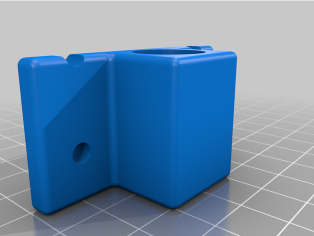

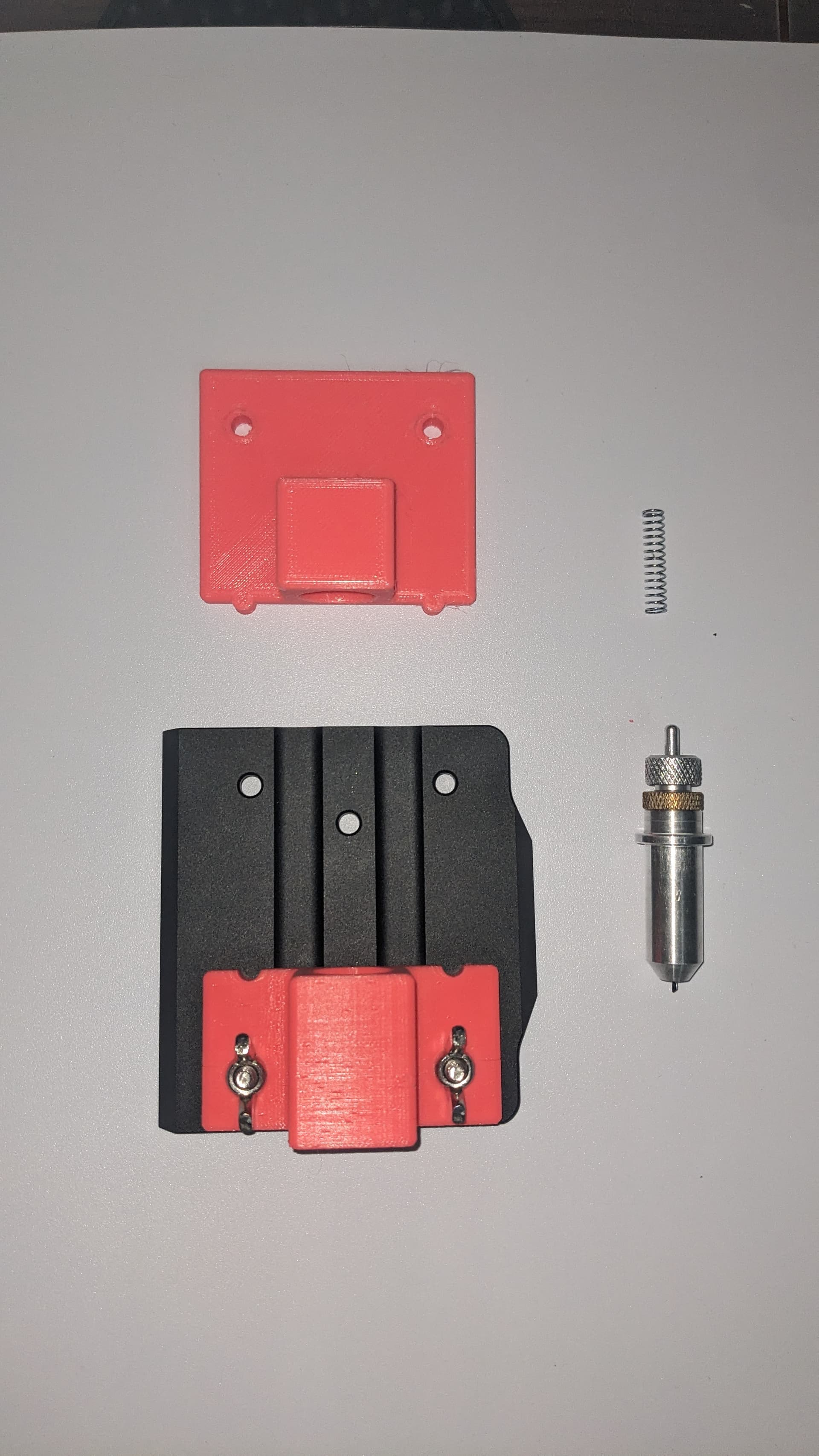

I have created a drag knife holder inspired by gil.a.ramirez that works with the Quick Swap Kit
Files are on Thingiverse:
It requires a compression spring which can be from a retractable ball point pen.
Use the CNC head on SnapMaker
Lower the blade until it barely touches the material to cut as your Origin.
Set your target depth and stepdown to .5mm, 1 pass
