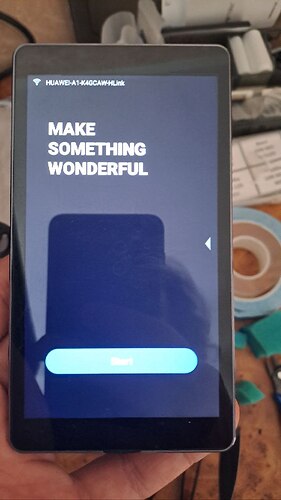

Good afternoon everyone, I’ve run into a problem and I wonder if anyone else has experienced this. Yesterday everything was fine, but today when I turned the machine on I noticed that the 3D printing tab had disappeared and the linear modules no longer respond to movement commands. I tried reinstalling the regular firmware (originally I had the beta version with vibration compensation V2.3.2), but nothing changed. It also won’t connect to Luban via Wi-Fi — it just says ‘Disconnected,’ even though the printer’s screen shows that it is supposedly connected. A factory reset doesn’t fix anything either; it doesn’t even forget the Wi-Fi settings
UPD: By disconnecting and reconnecting the wires, I found that the problem occurs when the Z-axis is connected. Now the question is: could the connection port be damaged (and can the connection be reassigned to another port), or have the Z-axis linear modules themselves failed?
UPD2: I tried swapping the Y and Z wires, and everything powered on normally, but the linear modules do not move. I also tried loading filament, but the extruder does not respond to commands, although the heating works.

Its possible but i think the issue comes from the toolhead (due to firmwareupdate) or its port (wrong way connection?).
Have a look here (be cautious):
https://snapmaker.github.io/Documentation/gcode/M1029
The default port configuration:
M1029 E1 X3 Y4 Z5 B6
Connect your machine over serial connection for editing the port configuration and save it with M500 and restart the machine afterwards.
